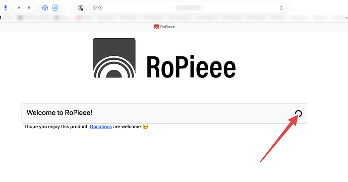

But is the process stalled if it doesn’t get beyond this stage, please, Harry?
The same thing happened last update - and I don’t want to risk interrupting it:

Can you just pull the plug and see what happens if you fire it back up?
Of course. I did just that. I expected to get the full interface.
But get the same thing…
If I remove the ā€˜/init’, I get the tabbed control panel I’m used to - also with RoPieee 2026.03 (3367) [STABLE]
Would I be right in thinking that the update process did complete, but something just hung?

The good news is that you’re running on 2026.03: all is good.
However, I see continuous disconnects from the web-page, which I can’t explain. And if this happens during the update and the startup, I can imagine you get the behavior that you’ve seen.
Which browser are you using if I may ask?

Indeed. I can see that. It’s only happened in the last two updates.
Safari (26.3.1 (21623.2.7.11.7) on Tahoe, macOS 26.3.1)
If that turns out to be the cause, I’ll happily switch to accessing RoPiee on FireFox.
Well, if that’s reason why I see this messages, I still wanna know (and fix :wink: ).
Anyways, for now just enjoy the music and I’ll see if I can get access to Safari.
Definitely. Happy to help if I can in this… :slight_smile: . Good luck!
