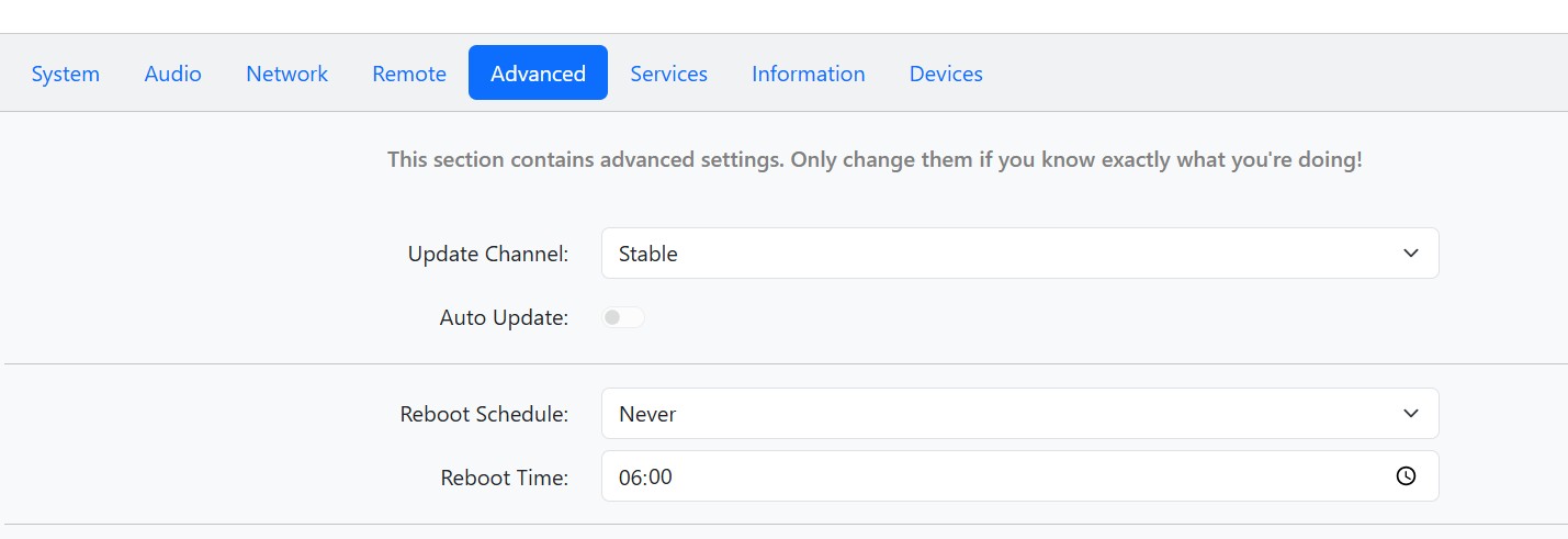

I don’t remember that ā€œAuto updateā€ features was active in previous, stable version?
Right now this features is inactive for me.
Regards,
Bruno
It has been there ā€˜forever’. Auto update requires a reboot schedule, which on your unit is disabled.
I’m sorry Harry, maybe this is my covid fog :slight_smile:
Of course I should turn Reboot schedule on by set daily/weekly… option.
Regards :slight_smile:
