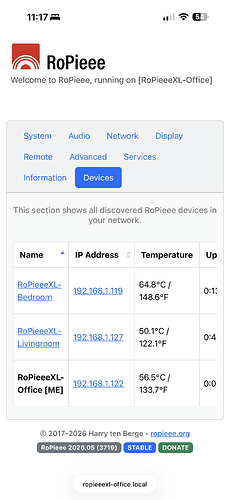

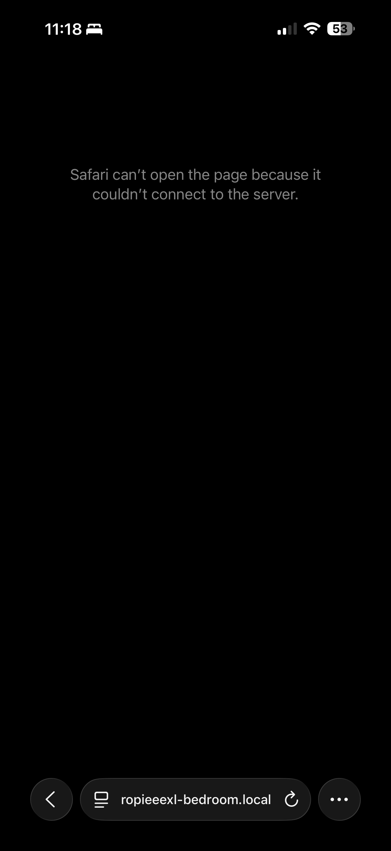

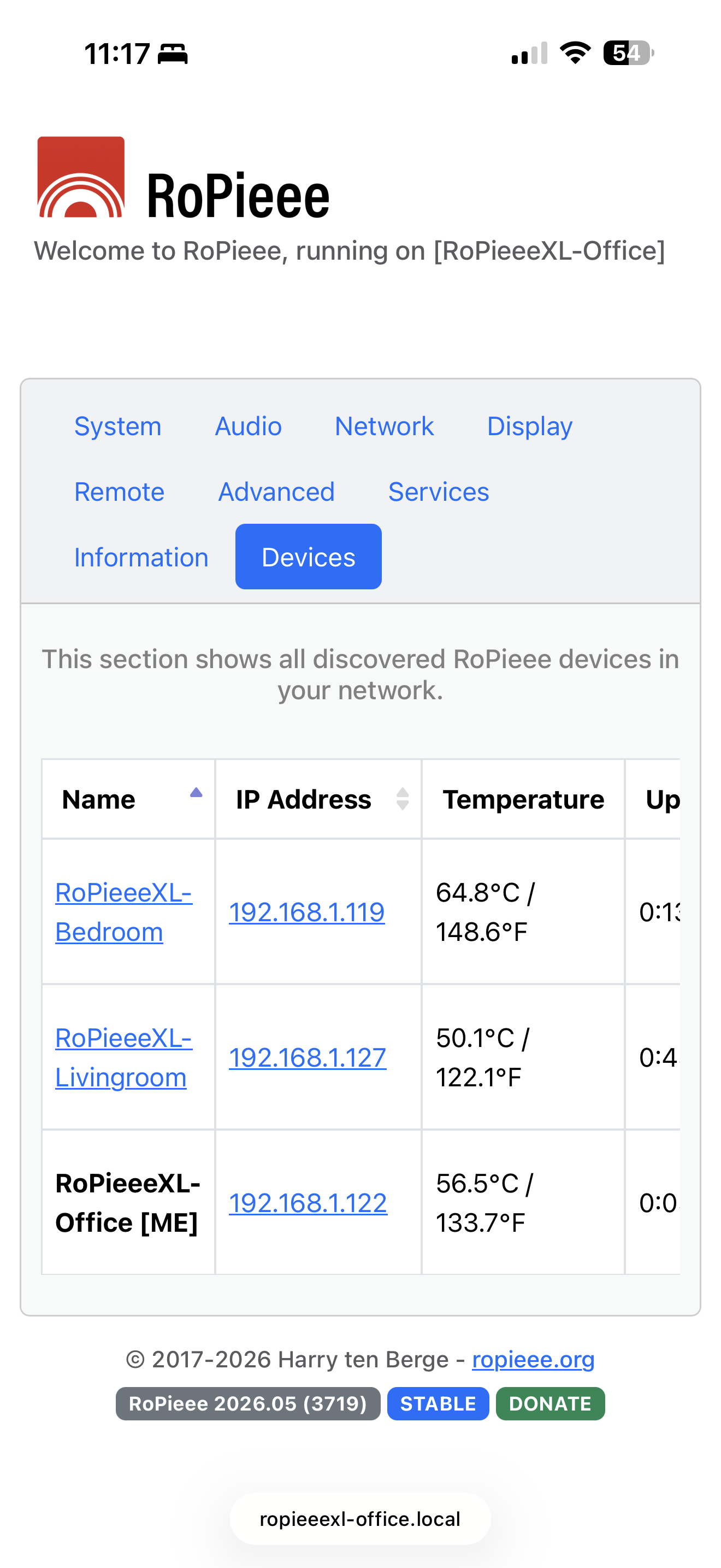

I’m having issues with one of my units. It’s recognized by Roon and it’s working properly. However, I can’t connect to it over the web browser inputting the IP address or the zone name. It’s showing on Devices but all I get is this message:
The one having this problem is the Bedroom unit. Of course I can’t send logs because I can’t access into it. Do I need to reflash the SD card?
Try first to pull the power cord and see if it reboots and become accessible, if not I’m afraid there isn’t anything to do but reflash

oops, update: instead of restarting, I totally disconnected the electricity for a few minutes, and then it booted up fine. issue solved.
Reflashing fixed it!
