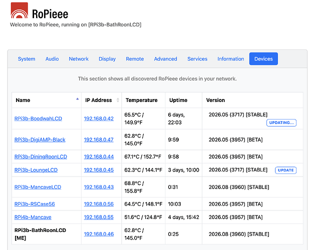

All my STABLE units updated perfectly but all my BETA units are still sick at 2025.05
I’ve changed all my beta units to stable now in the hope they will burst into updates and catch up again

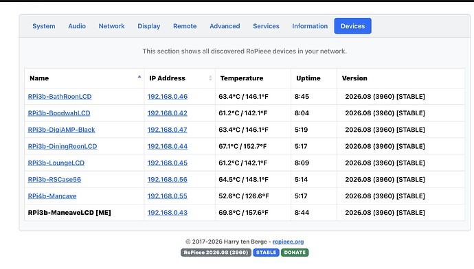

So that worked…maybe ill leave a few more on stable for now, and do the same with some others not currently running
