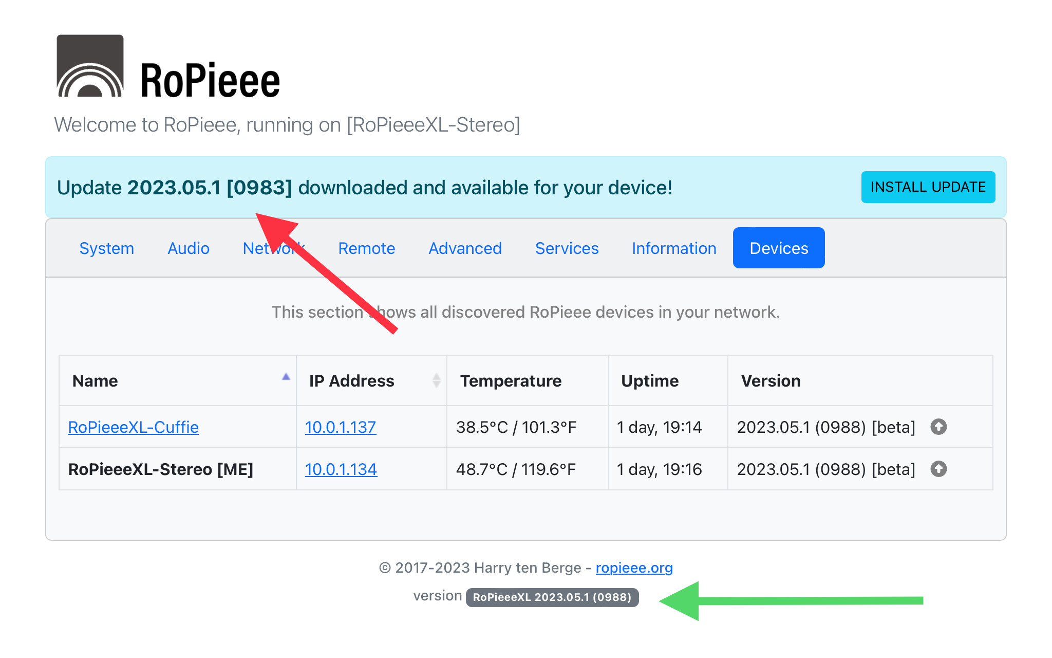

@spockfish Hi Harry, since few updates Iām facing a strange behavior.
I run RoPieeeXL in beta mode to be able to edit some Squeezelite parameters (the āfamousā -b parameter).
If I update RoPieeeXL to the last stable release and turn on beta mode Iām requested to install the last beta release thatās older then the last stable release.
in the screenshot you can see the last stable release (green arrow) and the notification of a ānewā beta release (red arrow) thatās older than the stable one, is there anything that can be done to solve this behavior?
Thanks
Iām not entirely sure what you meanā¦
Indeed the last beta is older than the latest stable version.
And thereās nothing in the beta release thatās not in the stable.
So ⦠I think you donāt need beta.
And indeed, if you go for the beta release youāll receive the latest beta.
Thanks
But if I donāt run beta I donāt have the chance to edit the /opt/RoPieee/apps/squeezelite/run.sh file to insert the -b parameter and even if Iām already on a newer version Iām requested to āupdateā to an older version
If youāre on the beta program it will indeed show the update to the latest beta, which can be older than the latest stable.
You can of course ignore the message.
Ok, that makes sense otherwise no new software version would be detected! Thanks Harry!

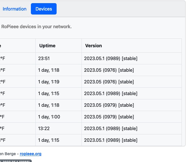

Iām seeing a bunch of devices on 5.1 and some still on 5.0 with no updates availableā¦is there a clock ticking somewhere?
also some timezones show Asia/Singapore and others just Singaporeā¦this seems odd
.1 is only available for XL
I thought everything was basically XL now? I donāt see any explicitly XL to downloadā¦.or anywhere to turn on XL services tabā¦did I miss something?
No, thereās still āregularā and āXLā. Except that:
