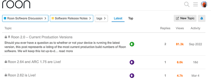

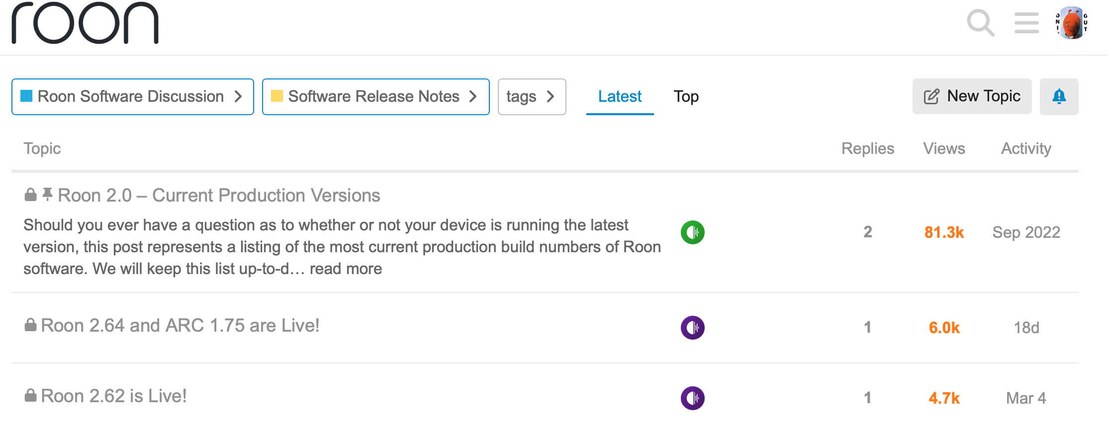

The latest production version of Roon is not 2.65 but 2.64:
See:

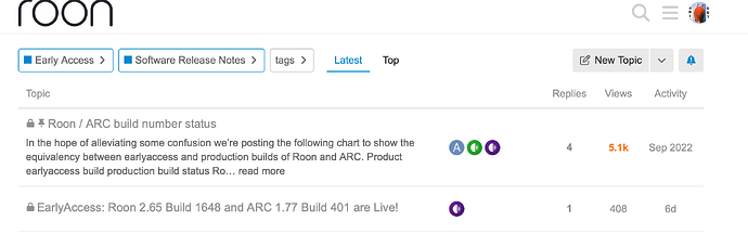

2.65 is the latest Early Access test build:
See:

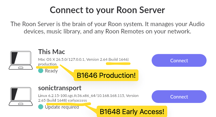

Edit after you posted the screenshot:
The fact that the message says “update required” for the server is probably just a confusion caused by the mismatch of Early Access and Production. It’s not that you have to “update” the server, it’s just that the versions don’t match. Either change the server to Production or change the remote(s) to Early Access.
