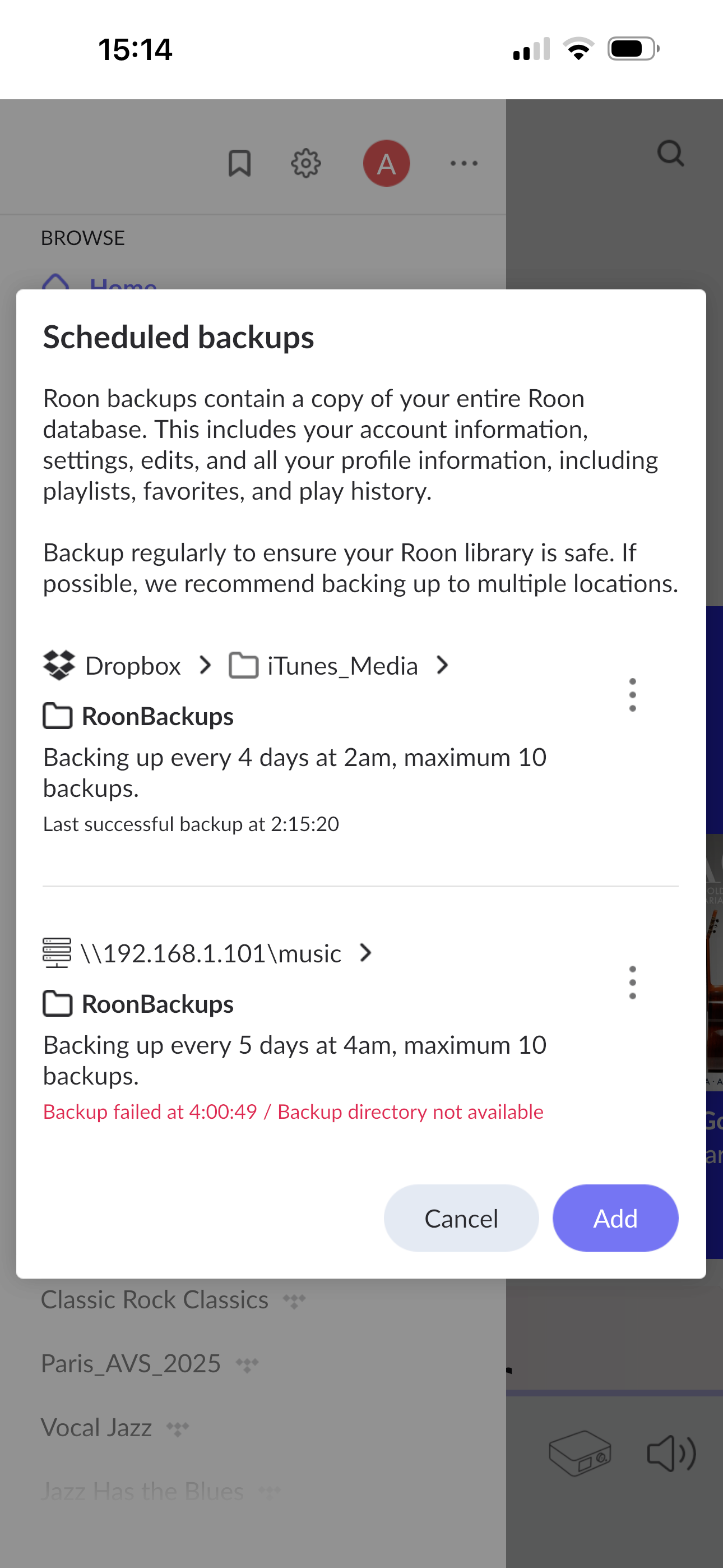

Roon server is on an Intel NUC with ROCK installed. It is connected via Ethernet to an SFR box. So is the Synology NAS to which I wish to perform backups.

Hi Alex, just tried at 4:32 PM local time. Still getting message Backup directory not available.
