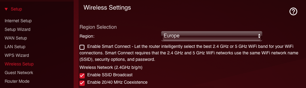

  2. I also deactivated “Smart Connect”

Thanks for letting me know my suggestions didn’t resolve the issue. I believe the VLAN aspect might warrant a closer look. Do you by any chance have any “multicast” options for that VLAN? Or is there a “filter multicast” setting on your router? If so I would try toggling that off. A screenshot of your VLAN settings may also help identify the issue here.

Hi @noris ,
I just added some screenshots which could be interesting.
There is a “RIP Version” setting which is in Multicast (RIP_2M) - I also added the support description of the router manufacturer.
