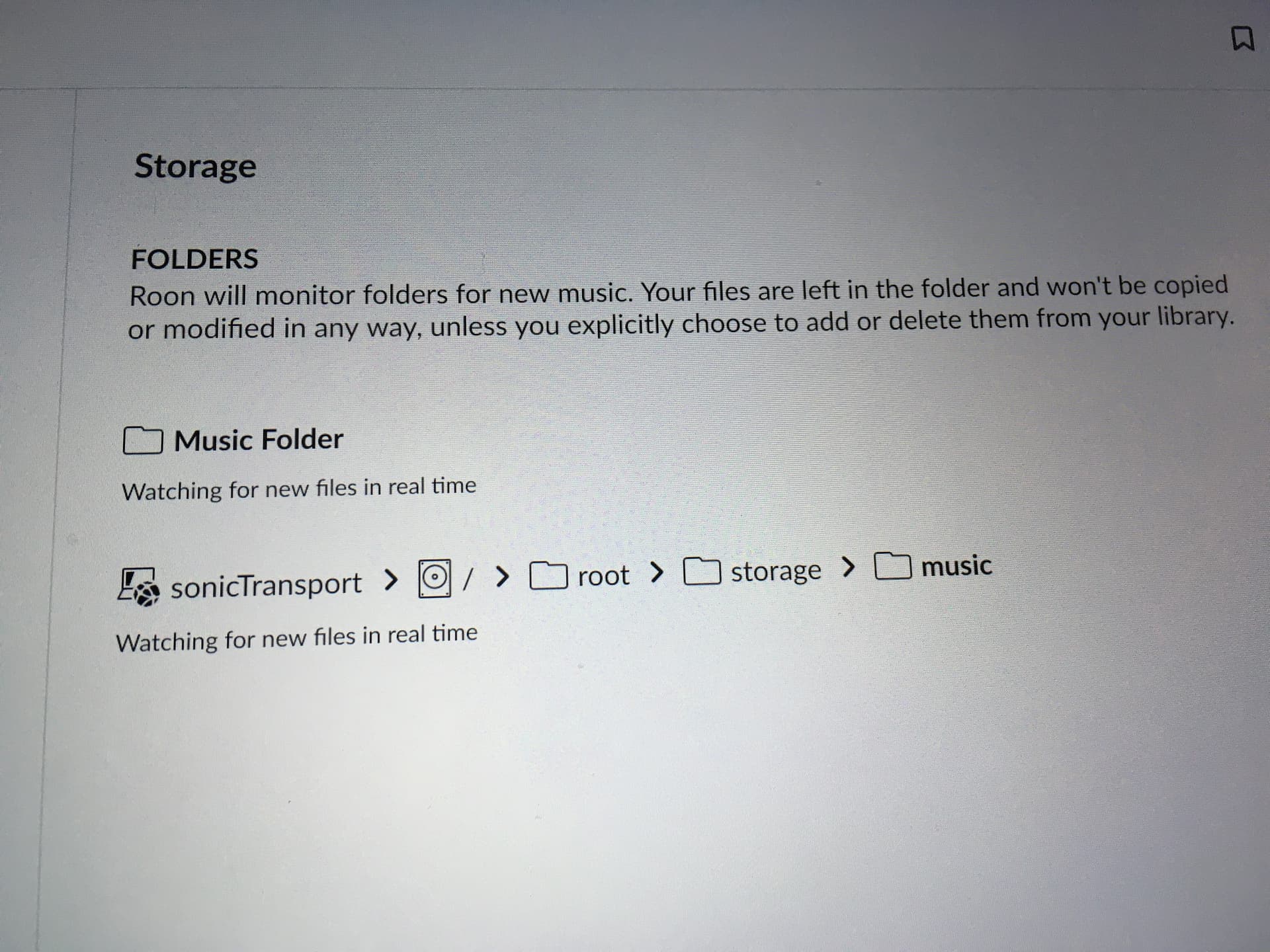

This seems to show that the file path I used was followed but no tracks were found. When doing setup, Roon prompted me with sonicTransport=HD/=>root/ to which I added my folders storage and music. Obviously this didn’t work. Should “root” be in the path, is something wrong?
Thanks

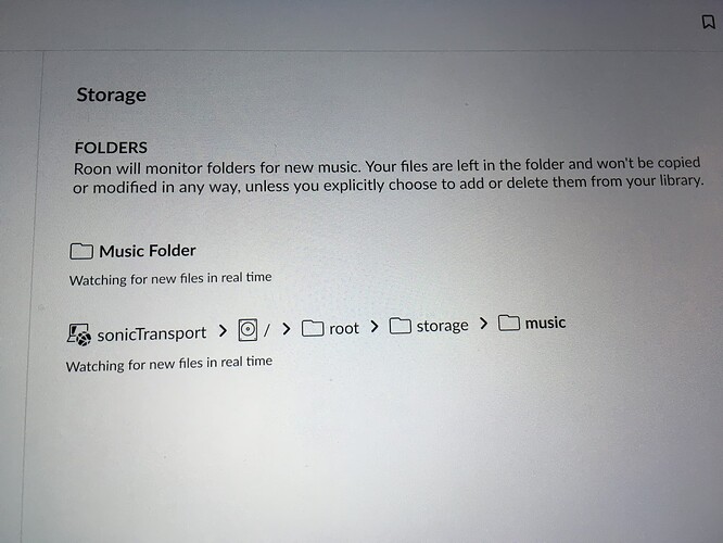

Can you post a screenshot from settings:storage showing exact path for your music folders?
Here are my settings:
I solved the problem! The music path was incorrect after all. Thanks
