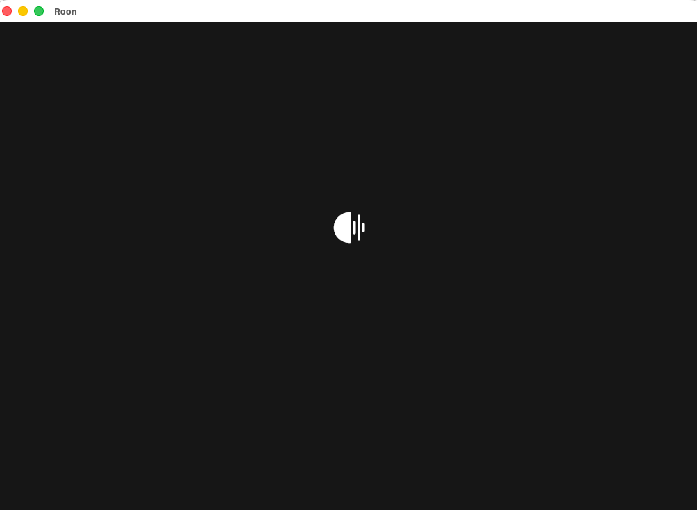

I have Roon Server running on my QNAP NAS. Everything has been working fine for months. Since this morning, the Roon app on my Mac and Roon ARC on my phone can’t connect to the Roon Server. The Roon Server is running on the QNAP server. The Mac has local network permissions enabled for Roon. I’m able to connect to the QNAP server as normal, browse files, use other apps, etc. All was working and then out of the blue just stopped. I’ve rebooted the QNAP server, restarted the apps. Upon startup, the Mac Roon app just spins the icon, never prompts about anything. Roon ARC says “Roon Server Offline”. I have been using Tailscale for months as well which improved the Roon ARC connection, and that has been running fine. I’ve tried it with Tailscale turned off as well. So at a loss as to what happened…

We have checked the diagnostics report from your RoonServer and were able to confirm that the problem is caused by your QNAP NAS failing to establish a secure connection to our cloud servers. The logs indicate repeated SSL connection failures and timeouts when the server attempts to reach the Roon network. Because the NAS is blocking or dropping this outbound traffic, the Roon Server is unable to authenticate and go online, which is why your Mac cannot connect to it.

Thanks for that in-depth look. I went thru a lot of AI-suggested solutions, re-installed QNAP firmware, re-installed Roon, etc. but couldn’t get it working. I noticed those connection issues as well. It never got fixed. I ended up installing Roon in Container Station and it’s working snappy like a champ. I understand this may not be the supported way for QNAP support, but it seems to work a lot better with my setup. I’ll keep backups and see how it goes.
