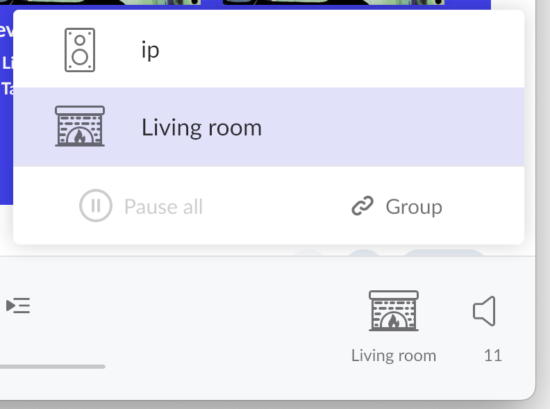

running Roon Core on Mac mini (2018), sequoia 15.2 and Eero network pro 6e now for over a year. in the last 2 weeks, my remotes do not show up for play. only the living room (main-mac mini to stereo there.)
so, kitchen (iPad), iPhone, or home theatre do not even show up as audio nodes. Somehow they showed up last week but for just a day. now they're gone. I've rebooted network, the cable modem, the server, Roon several times. kinda crippled in terms of playback if you ask me.

Yes they don’t show up there either. Strange.
