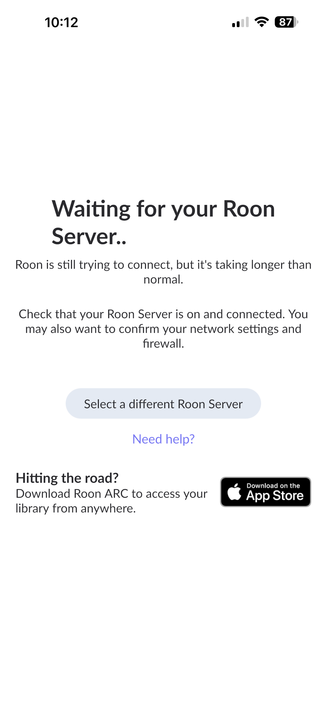

Remotes show 'Waiting for your Roon Server' with slow performance (ref#7GJ4YY)

· Every time app starts - May 9 at 2:08am CT
Remotes show “Waiting for your Roon Server” / other slow performance

No change after doing that.
Roon remote also seems slow on the server Mac mini.
Arc is also taking a long time - 20-30 seconds - to start playing after hitting play. And that’s on WiFi that is running > 400 Mbps (6Ghz).
