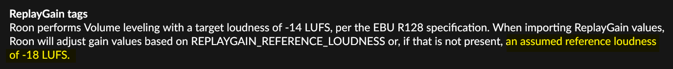

After looking into this more deeply, it seems clear that you should always use EBU R128 with a target of -18 LUFS when generating ReplayGain values. Most media players assume –18 LUFS as the reference point, not -14 LUFS, so choosing a different target can easily lead to inconsistent or unexpected results.
Roon is one example: its Loudness Volume processing is built around the assumption that ReplayGain tags follow the -18 LUFS standard. If you generate ReplayGain at -14 LUFS instead, Roon’s loudness calculations will be off by 4 LUFS. But this isn’t unique to Roon, other players behave similarly.
In theory, the REPLAYGAIN_REFERENCE_LOUDNESS tag could solve this mismatch, but no major software actually supports it, and it appears to be effectively deprecated.
If you prefer playback around -14 LUFS, the correct approach is the one foobar2000 uses: keep ReplayGain tags at -18 LUFS and apply a +4 dB preamp. That preserves compatibility with players that expect the standard reference while still giving you the louder target level you want.

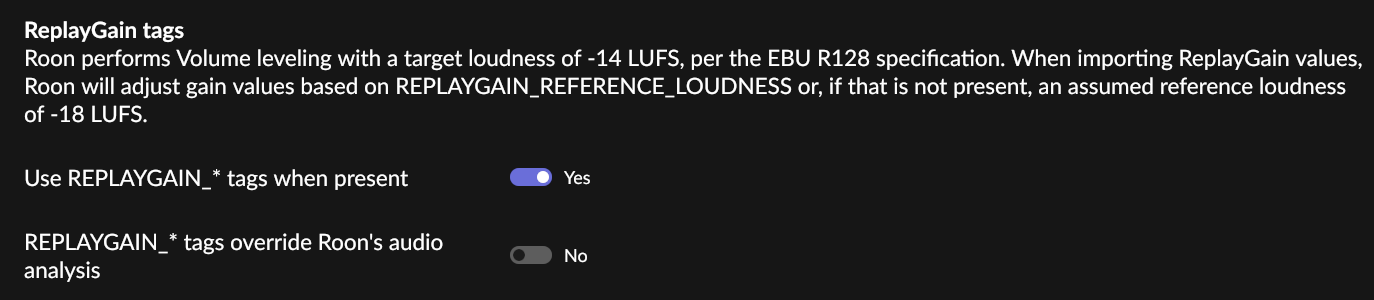

What is the effect of these settings:
I’ve recalculated and re‑tagged all my files with ReplayGain tags (album + track), clip prevention, 4× oversampling peak calculation, and a target of EBU R128 at –18 LUFS.
Will Roon now use the ReplayGain tags to reach –14 LUFS (i.e., apply a pre‑gain of +4 LUFS), or will it use the ReplayGain values as-is and keep the –18 LUFS target?
What is the effect of enabling or disabling “Use REPLAYGAIN_* tags when present”, and what is the effect of enabling or disabling “REPLAYGAIN_* tags override Roon’s audio analysis”?

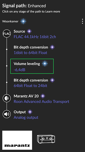

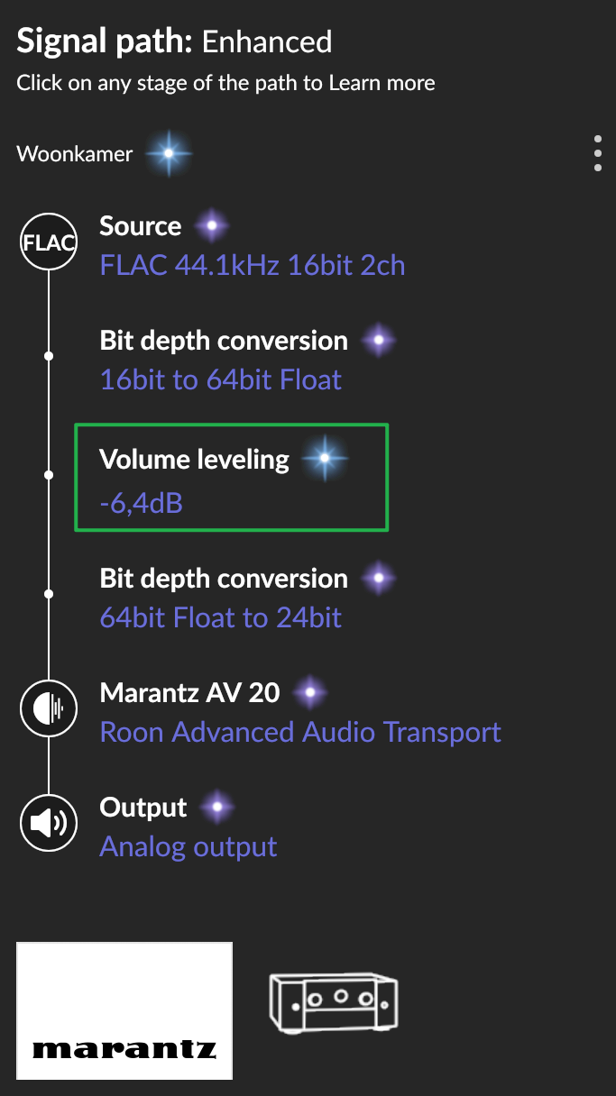

You can check this in the signal path during playback.
If a file is rg -10 to meet -18 LUFS and you ask for -14 LUFS it will be attenuating by 6dB not 10.

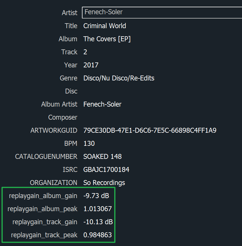

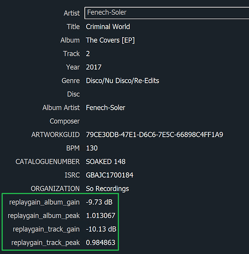

Thanks, @David_White1 to show me where to look. However, I’m unable to match the numbers. (It should apply album gain)
I believe the option “Use REPLAYGAIN_* tags when present” only takes effect when Roon has not performed its own audio analysis, though I’m not entirely sure in which situations that actually happens.
To get Roon to apply the ReplayGain values in my case, I had to enable “REPLAYGAIN_* tags override Roon’s Audio Analysis.” Once you do that, the math is mathing.

Yes you need to enable “REPLAYGAIN_* tags override Roon’s Audio Analysis.” for this
