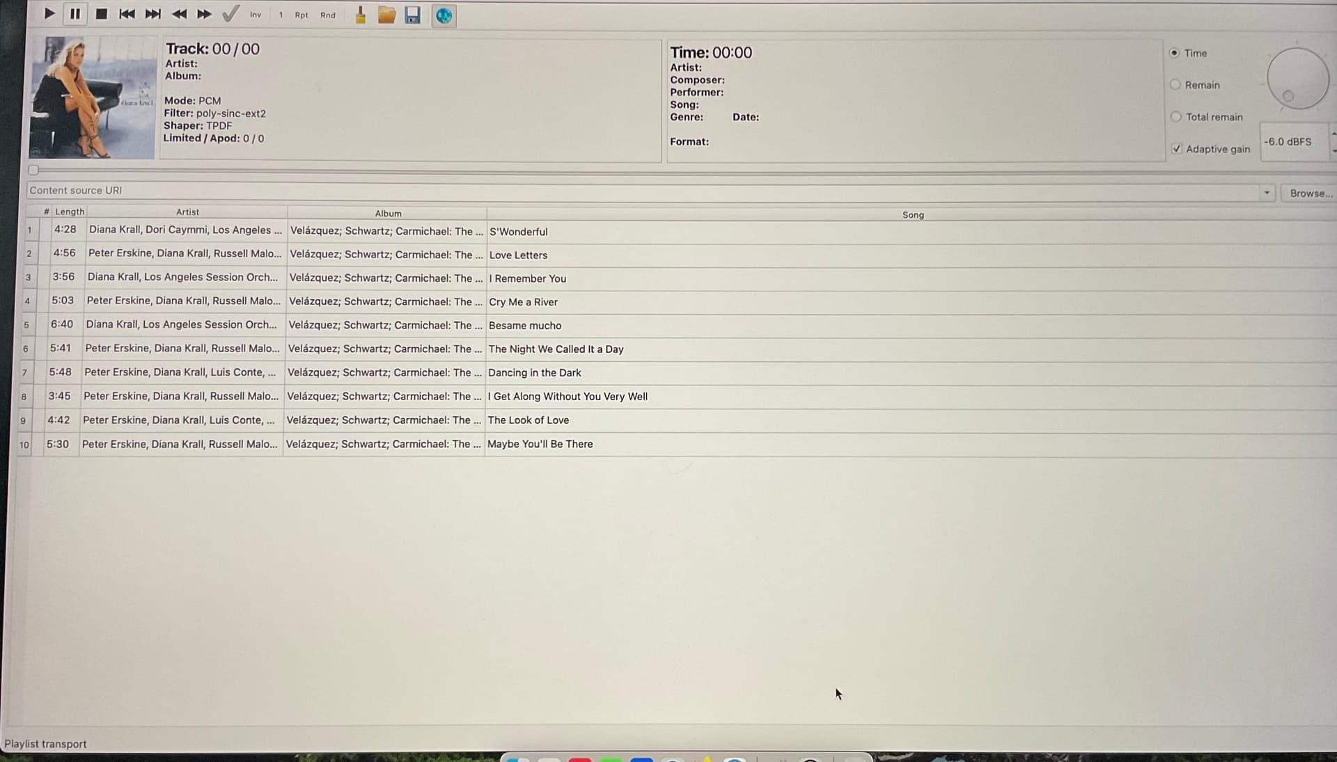

I am attaching two copies of my settings and I would like your advice on how to fine-tune these settings. I mainly listen to jazz but also pop/rock and a bit of classical. I use a MacBook Pro, Roon Nucleus, a Wattson digital connected to a Chord Hugo DAC. Thanks in advance.

Set “DAC Bits” to 24.
What is the maximum output rate you can get with this combination?
Your current settings are otherwise a good starting point. I would suggest to take a look at the manual, there are some suggestions in the filter table.

What do you see as output format here:
Screenshot from 2022-04-16 02-57-50
192k / 24 / 2 → 44.1k / 16 / 2
In this case I would change the Nx filter to poly-sinc-ext2 as well, since you are converting sampling rates down instead of up. You can also try something like poly-sinc-gauss-long.
However, I would recommend to look into some other interface towards your DAC, such as Audiowise SRC-DX. Because it can do much more than 44.1/16.
