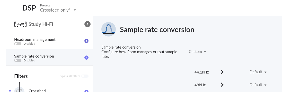

I do want to make the i2s connection working. Right now I upsample the 44kHz audio files to 96kHz. In the process they get converted to 32 Bit. As there are almost no 16 bit files of other sampling rates than 44kHz, this works most of the time.
Is it correct, that headroom management does no resampling. But If I turn on headroom management it gets appliad to all files
What is better resampling of all 4kHz files or headromm for all the files… ?
Headroom won’t resample, but the bit depth will change to 24 bits. Alternatively, set a custom rule for 44.1 kHz. Yes, this is applied to everything.
Neither. It’s a matter of choice. Incidently, I used headroom as an example. Cross-feed would work too, as would any DSP.
@Martin_Webster , thanks for the fast replies. I will use a custom rule for 44kHz.
