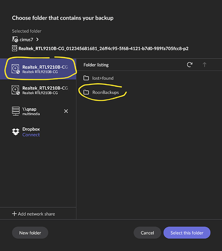

The order of steps is this:
You select the USB drive in the left column of the window, and then the RoonBackups folder. Do NOT go deeper.
Don’t
So for me this looks like this, click the RoonBackups folder here:
Now click the Select this Folder button

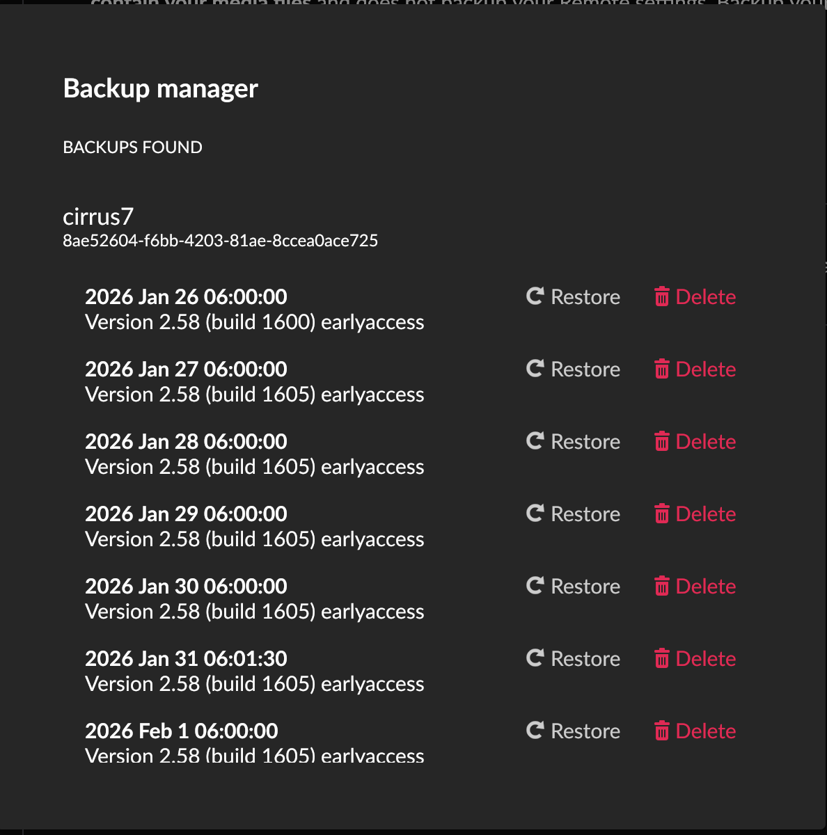

The backup manager will look for backups in this folder and you can choose the one to restore (there may be only one if you created a new, separate backup; in my case it’s many because these are automatic incremental backups):

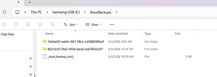

Screenshot is below. Here’s some background information……..
I just updated my RoonOS/ROCK to run in UEFI bootmode instead of BIOS BOOT so that I could get the latest and greatest version of ROCK. Prior to doing that I did a manual backup so I thought I would be good. The directions said after re-installing ROCK I could do a restore and that would restore my Roon Music Database…Well that’s not working out….I plugged the USB into my Windows Laptop and here is a screenshot of that. I really appreciate you helping me. It’s Cinco de Mayo so I will buy you a margaraita!!

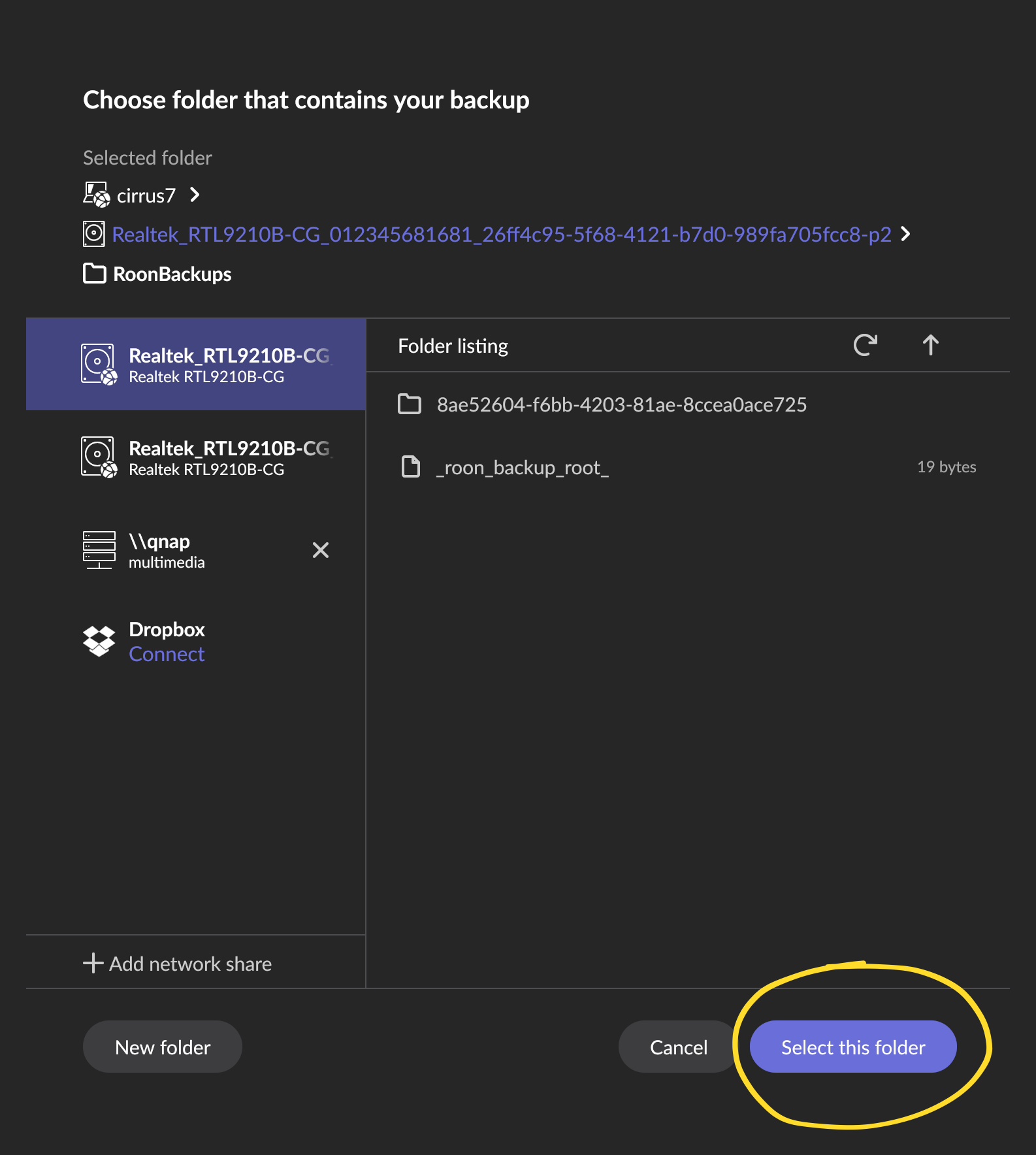

Until then, that roon_backup_root file is the key. It’s a marker file that tells Roon this is a valid backup location. Your backup structure looks correct, so the issue is likely which folder you’re pointing Roon to.
The InvalidRoot error means Roon couldn’t find the roon_backup_root marker file in whatever folder you pointed it to. If you were selecting one of the hex subfolders, that’s the problem, those are individual backup snapshots, not the root location.
When Roon asks you to choose a backup location, you need to select the RoonBackups folder itself (the subfolder containing the roon_backup_root file), not any of the hex subfolders inside it.
Step-by-step:
  1. In Roon, go to Settings → Backups → Restore
  2. Click "Add Backup Location" (or browse/change the folder)
  3. Navigate to your USB drive → select the RoonBackups folder and confirm
  4. Roon should now detect the _roon_backup_root_ marker and list your available backups
  5. You'll then see your backups sorted by date — pick the most recent one
