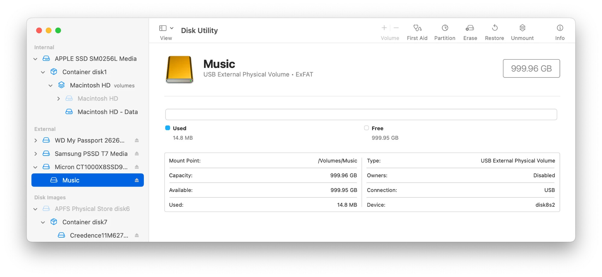

  7. I disconnected the drive and checked it independently on a Mac via Disk Utility, bypassing the ROCK entirely: the drive itself is completely healthy — mounts cleanly, valid ExFAT filesystem, no errors reported. But it shows only 14.8MB used out of ~1TB (999.95GB free). The ~700GB of music files are not on it. This rules out hardware failure or a bad cable — the drive was reformatted or otherwise had its content erased, not damaged.

  4. Logs show the new Roon Server instance never enumerated the drive in question. A single clean single exFAT volume with 14.8MB used is what a desktop format tool produces (like Disk Utility).
  • What exactly did you see when the drive was first connected to the MacBook: any dialog, any error?
  • Was Disk Utility opened with that drive selected at any point, and was anything other than First Aid run?

  3. Disk Utility showed no errors
  4. Yes, just for status - no First Aid run
  5. No, it went from Rock to macOS and now in storage
  6. I believe that the inital formatting and music files copy was done by macOS
  7. This is a screenshot from my mac soon after the incident. I only ran Disk Utility to get status

Your data is very likely still on that SSD. You reported 14.8 MB used out of 1 TB. That is the signature of a quick format, which rewrites the filesystem’s index but leaves the actual file data untouched on the drive. It is not the signature of a secure erase. So a large part of your 700 GB is probably still physically there, waiting to be recovered.
