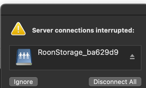

Had another outage notice tonight around 8pm CST. And,other than unplugging the Raspberry Pi, I don’t know how to diable the Extension manager.
The error image is here:
occurring our 10pm. I’ll jyst continue to post until one of use discovers areason for these down performances. MANY THANKS JOHN V
