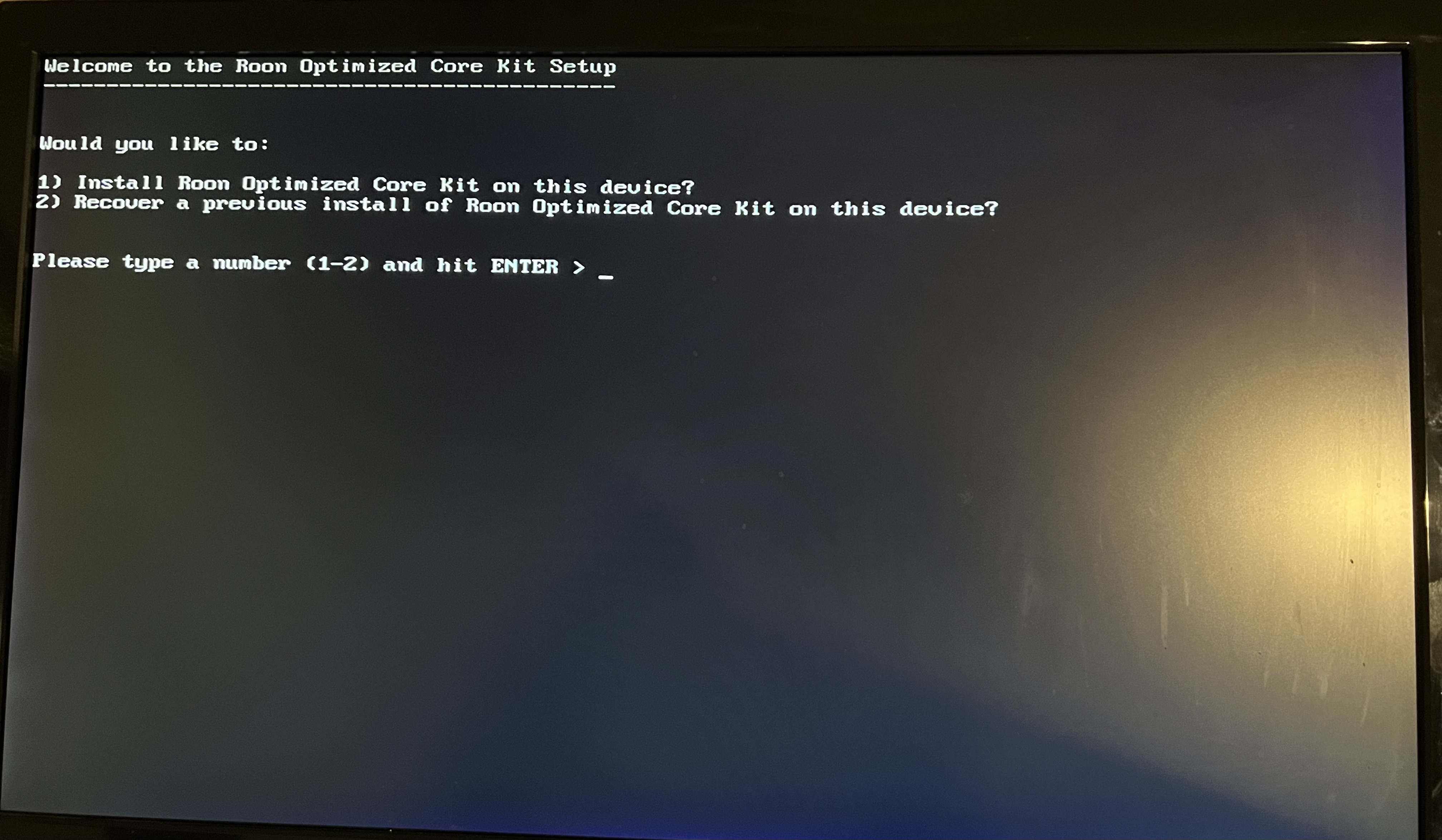

After replacing a failed M.2 SSD, I’m attempting a USB flash ROCK install on my Nucleus. I believe I have my BIOS settings correct (boot priorities, fast boot is off, secure boot is off) but when I boot to the install menu (see photo), the keyboard becomes non-functional. I’m quite stuck. Any ideas why this is happening?..and/or what I can try next? Thank you so much.

Thank you. The BIOS settings remain at default and the keyboard functions properly with the BIOS interface.
The issue is - when I boot from the UEFI USB OS Bootloader, the keyboard is then somehow disabled. Thus I’m unable to enter the command to initiate the ROCK OS install.
My understanding is that the keyboard would function properly in the BIOS regardless of the settings. Which makes sense as you would not be able to change anything if the USB got disabled when in the BIOS setup.
However, when the BIOS hands the system over to the OS (in this case ROCK) the settings would then take affect. I was making sure that you checked the settings to make sure that the port you are connecting to is not disabled when the BIOS hands over the system. If the “default” is set so that the port you are connecting to gets disabled, then it would exhibit what you are seeing. Setting a USB port to be disabled by default, I would think, is not a desirable thing if that is what is happening… ?? Were any of them disabled? If they are all enabled, then we need to look elsewhere.

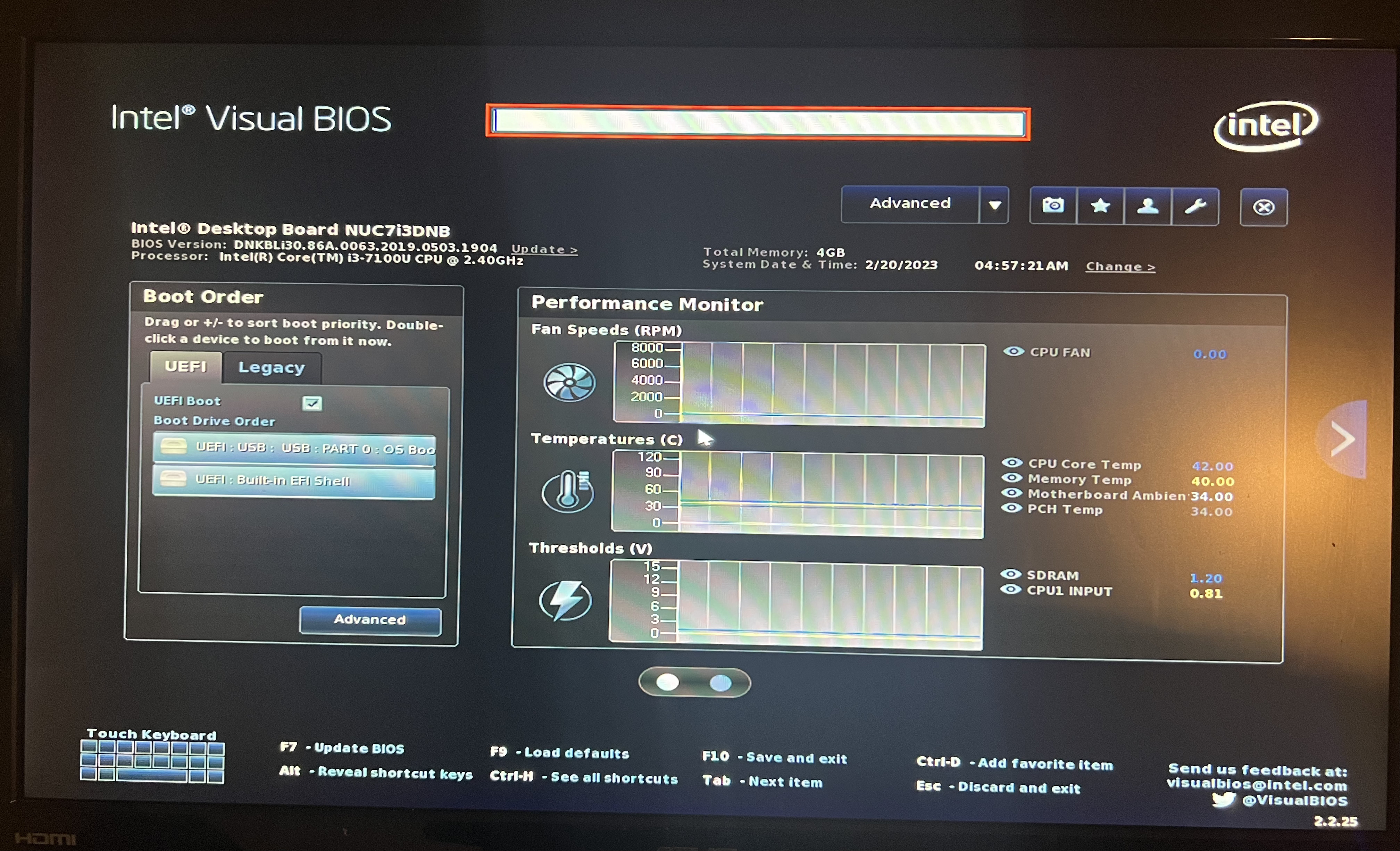

Here’s a screenshot of the default USB settings.

That all looks fine to me.
