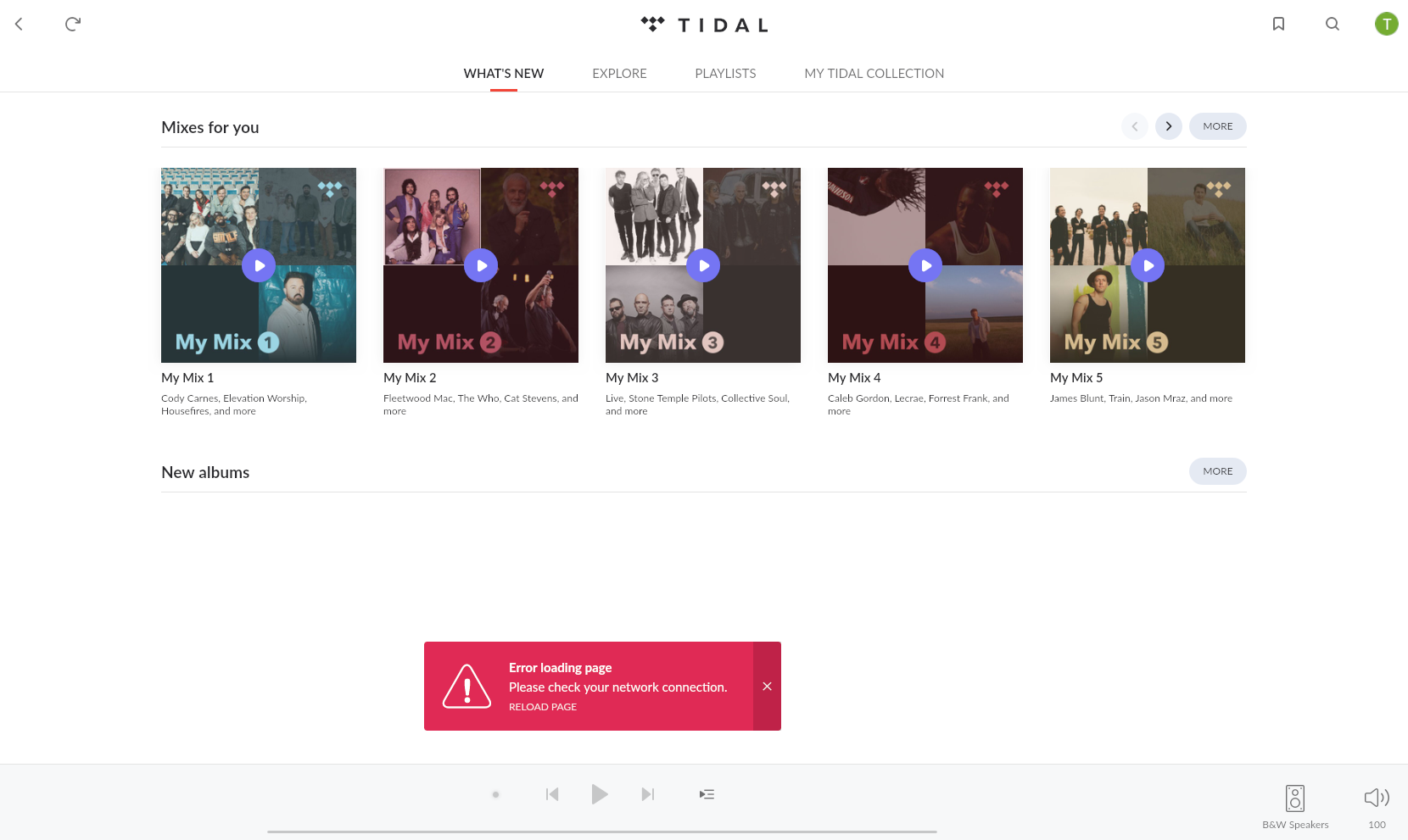

I have a ROCK server on a NUC that has been working fine. I just unplugged it to move some equipment and when I restarted I could no longer connect to Roon. I am able to connect directly to the IP address and manage the server but not through the Roon app on Windows or my iPhone. I've double-checked my firewall and nothing has changed. I am sometimes able to log in to my Roon server, but it can't connect to Tidal or search, and it quickly flashes up to the screen that says "are you online". It seems like an authorization issue, but I cannot solve it.

We reviewed the diagnostic data from your ROCK and noticed the system date/time does not match the current date, which can break cloud authentication and cause intermittent behavior in the Roon app. Please check the following network items that commonly cause that symptom:
  1. NTP / Time synchronization
From the diagnostics the clock looks wrong — ROCK may be unable to reach NTP servers.
Please verify on your pfSense that outbound UDP port 123 (NTP) is allowed for the ROCK’s IP and that there are no outbound rules or NAT redirects blocking NTP. When you have a monitor attached to the NUC, confirm the ROCK console’s date/time is correct.

Brilliant! I had an error in my NTP settings for that VLAN, which must not have been an issue when I first set it up because I configured it from a different VLAN. Once I fixed that, everything worked again! Thanks so much for your help…I would never have found that on my own!
