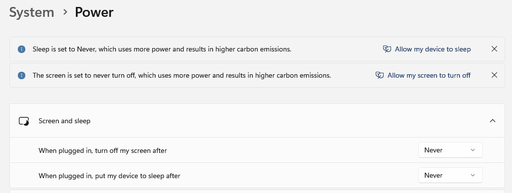

BTW, as this machine is solely for Roon, I have noticed that it goes to sleep and hibernates, despite changing the battery settings. Is there some trick to keep the WIN 11 machine ‘always on’. Bear in mind, I dont always have music playing all through the day.

I’m no Windows expert, but I believe that you can configure power settings in the control panel so that the machine never sleeps when it’s plugged in.
If you’ve adjusted power settings like in following screen shot, your laptop should stay on all time!

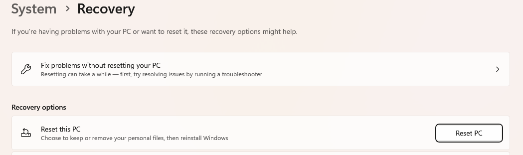

If it still does go to sleep, reset your Windows installation as in following screen shot and retry, since it’s fundamentally borked, somehow!

Incidentally, I had reset the WIN 11 laptop. I discovered additional power settings that were causing the machine to hibernate and adjusted these, so it no longer sleeps now (It stayed up all night, and Roon was able to play music in the morning)
