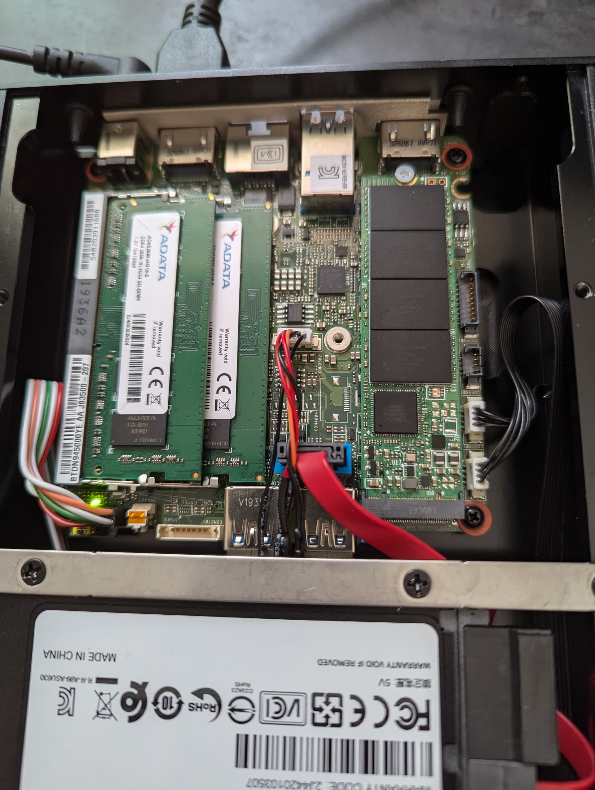

Thank you, yes had a look inside, all looks clean and it’s fanless and sealed so there was no dust. I took out and reseated memory, the 2 M2 drives and my SSD and tried again. I don’t get anything registered on the monitor (and used both HDMI ports), no boot screen, logo, no signal at all. Hitting F2 made no difference.

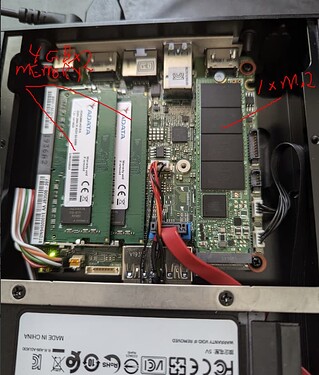

In your image it looks like there are two memory cards (the one I can see says it’s 4GB), but you said you only have 4G (with two 4GB cards there should be 8GB of memory). Maybe the memory is the issue? Try removing one of the memory cards and see what happens, then swap that one with the one you took out.

OK, thanks for suggestions, and for spotting that I don’t know the difference between the memory and M2 slots. I tried swapping the memory out and in different combinations with no joy. I then created a USB boot with the bios installer on it and used the power button menu (still nothing at all comes up on the monitor so had to do it blind) and left it for 10 minutes, but on restart still nothing, and on plugging it back in to the network still not recognised.
