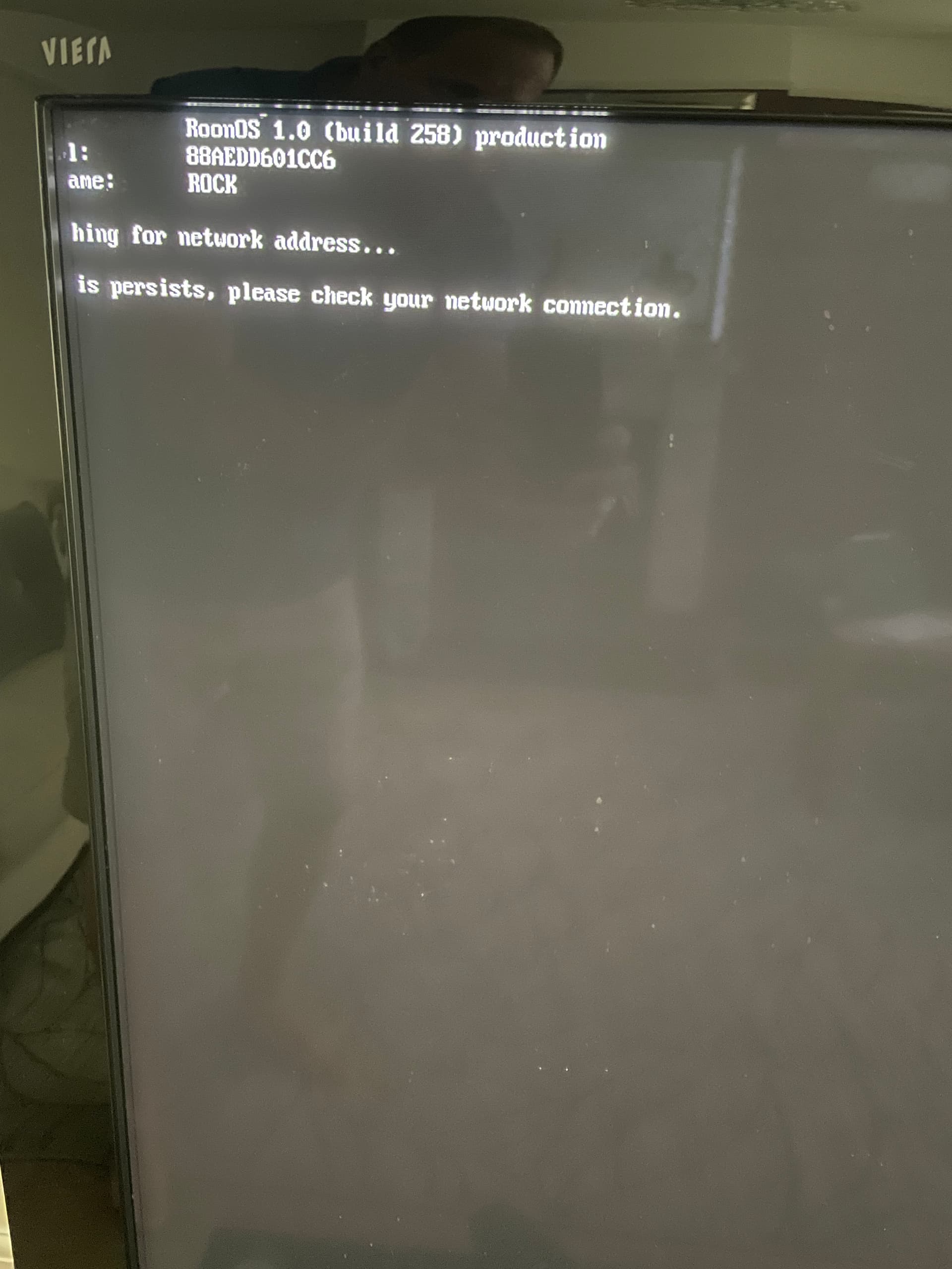

Hi,
I installed ROCK on the NUC, and after a few issues, everything was working fine for weeks. Then connection to the core was lost. I could still see its IP address on the network (192.168.0.154), but showing as incomplete. This is the same network as the router is on. Now I can no longer see this network address on the network.
When plugging into the TV to investigate what is going on, it is stuck on searching for network address. I have tried all the things I could find on your help, e.g. disabling ipv6 and so forth, but nothing seems to work.
It is very strange that it all worked, and now I cannot see anything I can do to get it to connect to the network again. I have restarted everything several times as well of course.
Any ideas of what to do would be appreciated.
Thanks

How is the NUC connected to the network? Wired connection to the router or to a switch? Have you tried a different cable?
Wired connection. Have tried different cables and different connections including directly into the router. Nothing works anymore, whereas it worked fine a few weeks ago.
I also tried the resetnetwork command, but that did not make a difference.

Hi @Morten_Andersen ,
Do you by any chance have a Linux-compatible USB → Ethernet adapter you can try? It’s possible that the networking port itself is having issues, and this would be a cheap/easy test. The other suggestion that I can make would be to try to reinstall ROCK again from the USB drive, perhaps an Operating System reinstall will sort the issue out. Do let us know your findings.
I bought a USB → Ethernet adapter, and it solved the problem! Quite surprised that the network port on a brand new NUC has issues, but it seems to work seamlessly now.
Thanks for your help
