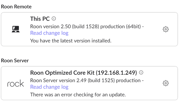

Thank you for your reply. I tried it serveral times over several days from April 30 until today, unfortunately still the same. Today I had ARC issues when not using Tailscale, maybe also related to the update issue?
Have rebooted the router and the NUC several times. As I wrote I use Pi-hole for Ad blocking. Rock uses static IP settings and circumvents Pi-hole. Gateway and DNS of rock point directly to the internal IP of the internet router. Other local clients that are configured by the routers DHCP get Pi-hole as DNS server. Pi-hole is used as the routers downstream DNS, non blocked queries are passed from Pi-hole to the router. It does not seem Pi-hole is involved in the rock update issue.

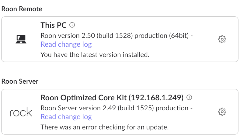

message that appears after update failure

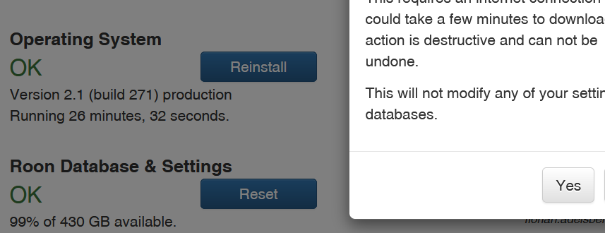

tried manual reinstall / update of OS and server from rock web interface but seems that did not work too

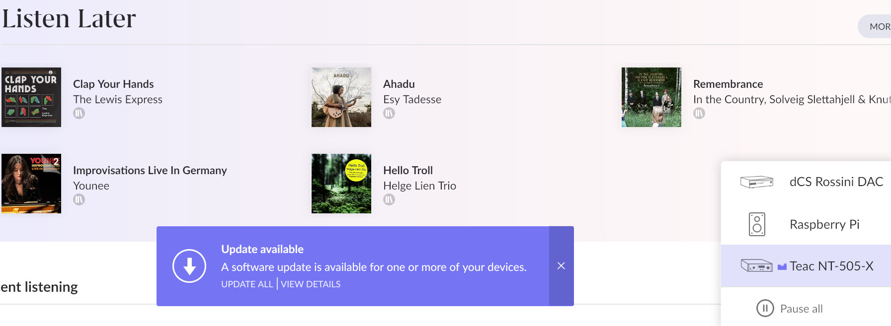

serveral times appearing update message - a bit annoying :slight_smile:

as I showed in the screenshot above I already navigated several times to the Roon OS interface at rock.local. I tried several times to initiate a RoonOS reinstall but that did not seem to work.
I also tried to connect to \ROCK smb share from a Windows 11 machine. Login as Guest and Password also as Guest did not seem to work?
Weird! Got a solution. Log out from Tailscale on RoonOS. Then the RoonOS reinstall and the update to build 1528 worked immediately.
