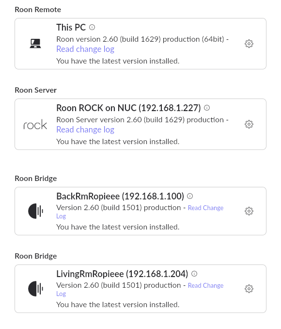

Wait, did something just change on Roon’s side? It had been failing since the update but I just tried the update again and it worked!
Maybe it did, or some sort of other glitch somewhere. Well, success in any case :slight_smile:
