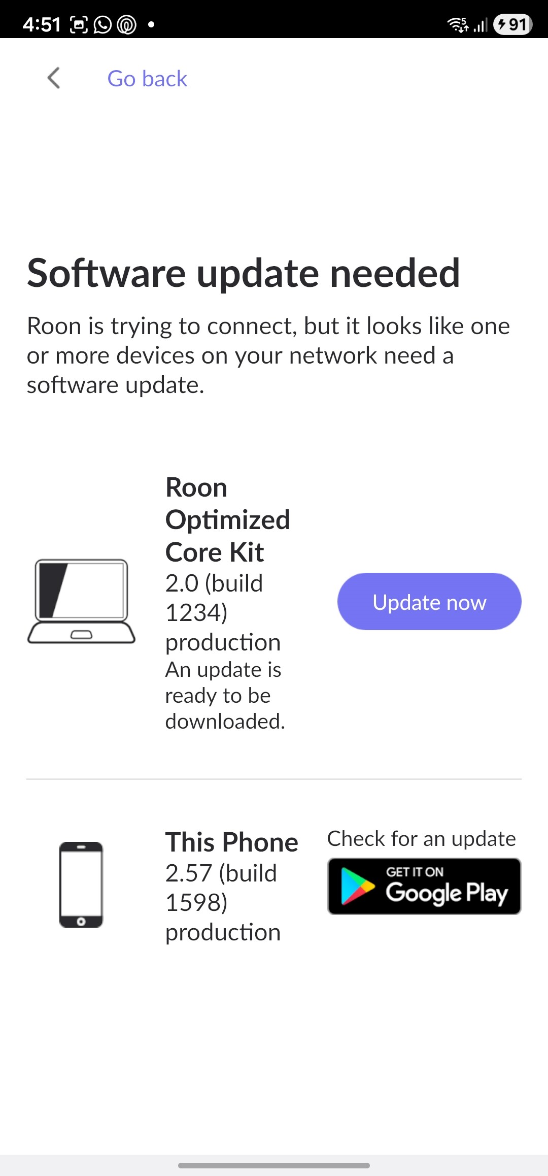

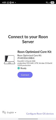

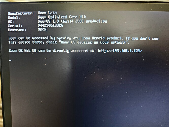

i just installed rock on my NUC, i then try to reach it via any of my remotes, and get the screen to select the rock as the core, I select rock, and then it prompts me to update the rock, the message downloading update appears, and then, it gets stuck in there, no update. and therefore, no fun. I`ve already tried installing many times de rock usb image previously downloaded from the help center to no avail. the version that appears on my NUC is version 1.0 (build 258).
i have my NUC connected via an ethernet cable to my internet router, I was previously using the same router with a legacy version due to hardware limitations which I`m trying to overcome using the NUC
Try the Reinstall button on the web admin UI as the instructions say (last bullet point in step 6)

I dont have a nucleus, I just installed roon rock on a NUC, the rock seems to be up and running, when I try to acces the UI, with any remote, I see the rock as an option to connect as a core when O clock in connect, it then asks for an update in the next screen, when clickong on the update button, it starts downloadi g the update but it stays there, it won’t go anywhere after that. I already tried to reinstall the rock several times but everything is still the same.
Did you follow @Suedkiez 's suggestion to use the Reinstall button on the Web Administration Interface of the ROCK/NUC? As he says, that is a necessary step in the ROCK Install guide.
Hey @Arturo_Saucedo,
Both @Suedkiez and @Geoff_Coupe are correct here - reinstalling RoonOS will update you to the latest version of Roon, and you should be all set to go.
Here’s more info on how to access the webUI:
Let us know if this helps!
