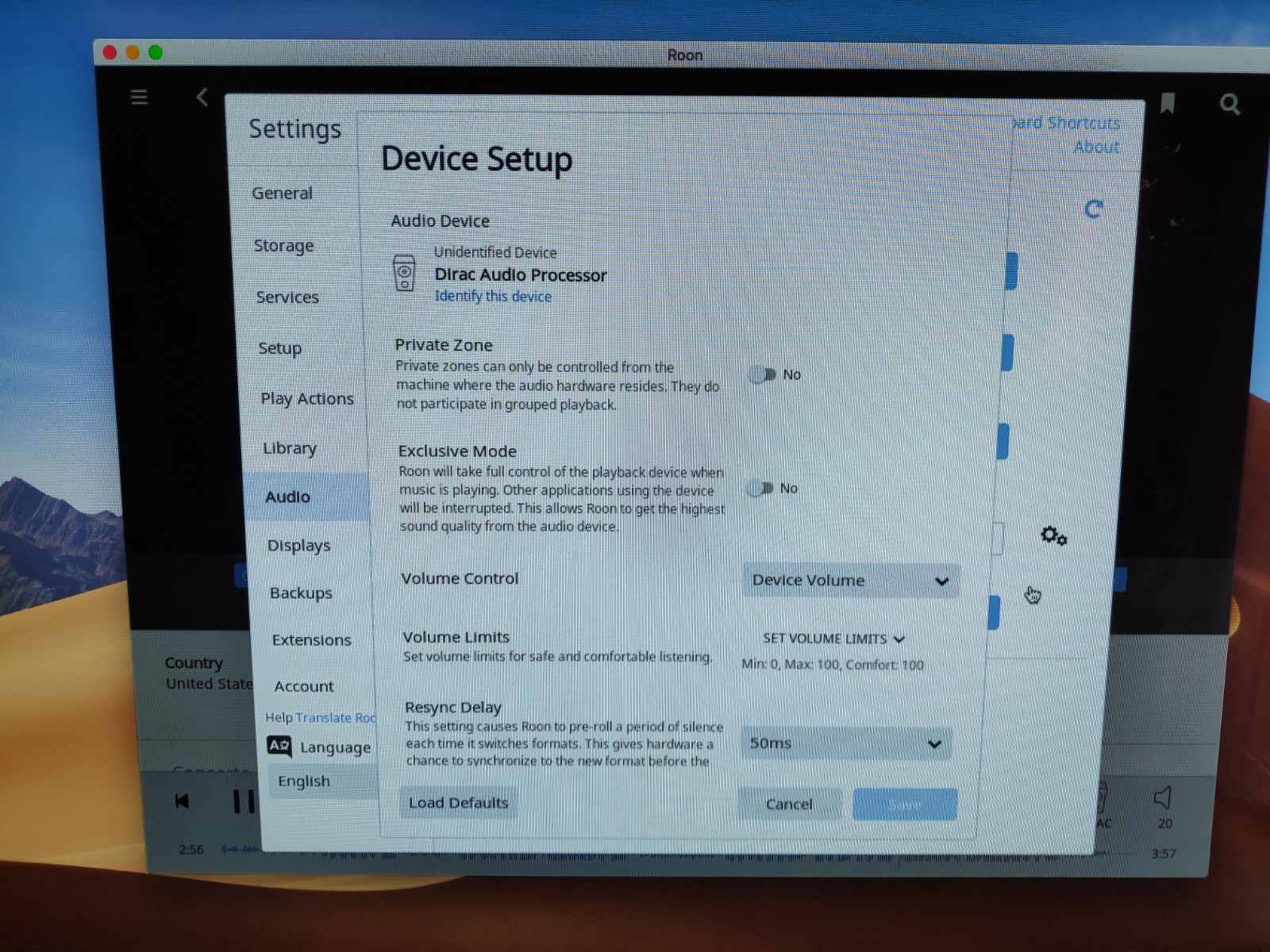

i installed Roon SW on my Mac Mini and all seems to be good.
But if i play music the music is very strongly distorts. No matter if I play from Harddisk or TIDAL. I also have DIRAC disabled and set the ADI DA converter for Playback, unfortunately without success.

i have disabled DIRAC and set the ADI DAC on my MAC as default.
Than i selected the ADI in Roon and it works fine. Do you have a solution that i can use DIRAC with Roon ?

Hi,
ok. I put the system output on my MAV to DIRAC and selected DIRAC in Roon. Hi Distorsions.
Than i let the System output on DIRAC and in Roon i selected the ADI DAC as an new zone.
No Distorsions.
Than i selected the ADI DAC on my MAC as System output. On Roon also ADI DAC no Distorsions.
With the same config on my MAC but DIRAC selected in Roon Distorsions.
Sometimes i think that the output of Roon is too loud for DIRAC also whan i set the Volume to 1in Roon.The highest Distorsions are in the Bass and lower frequency section
