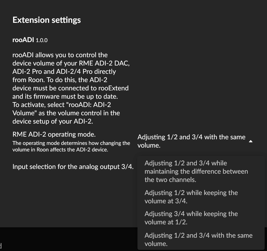

I have a configuration question.
I’m new to RME. I have an ADI-2/4 Pro SE. I have the rooADI extension licensed and installed. I have headphones plugged into the 4.4mm balanced out on the front and active monitors plugged into the XLR connections on the rear.
I have the volume knob set up to toggle between phones on 3/4 (which is the balanced out on the front) and 1/2 which is XLR on the back.
The issue I’m having is that when I’m playing through headphones, adjusting the volume in Roon correctly adjusts the volume (via the extension). When I switch to the XLR outputs, adjusting the volume in Roon does not adjust the output volume on the RME. The volume knob on the device itself works, but changes made are not reflected in Roon. When I change it in Roon, Roon adjust the displayed volume in Roon itself, but no change is made to the device.
Is it possible to get this work? Do I need to link the volume on the RME or something like that?
Never mind - I needed to re-read the manual. I’ve adjusted rooADI’s settings and it’s now doing what I want. Thanks!
Have you ever checked this option on rooADI?
Using the first displayed option you should be able to control both.
Best DrCWO
