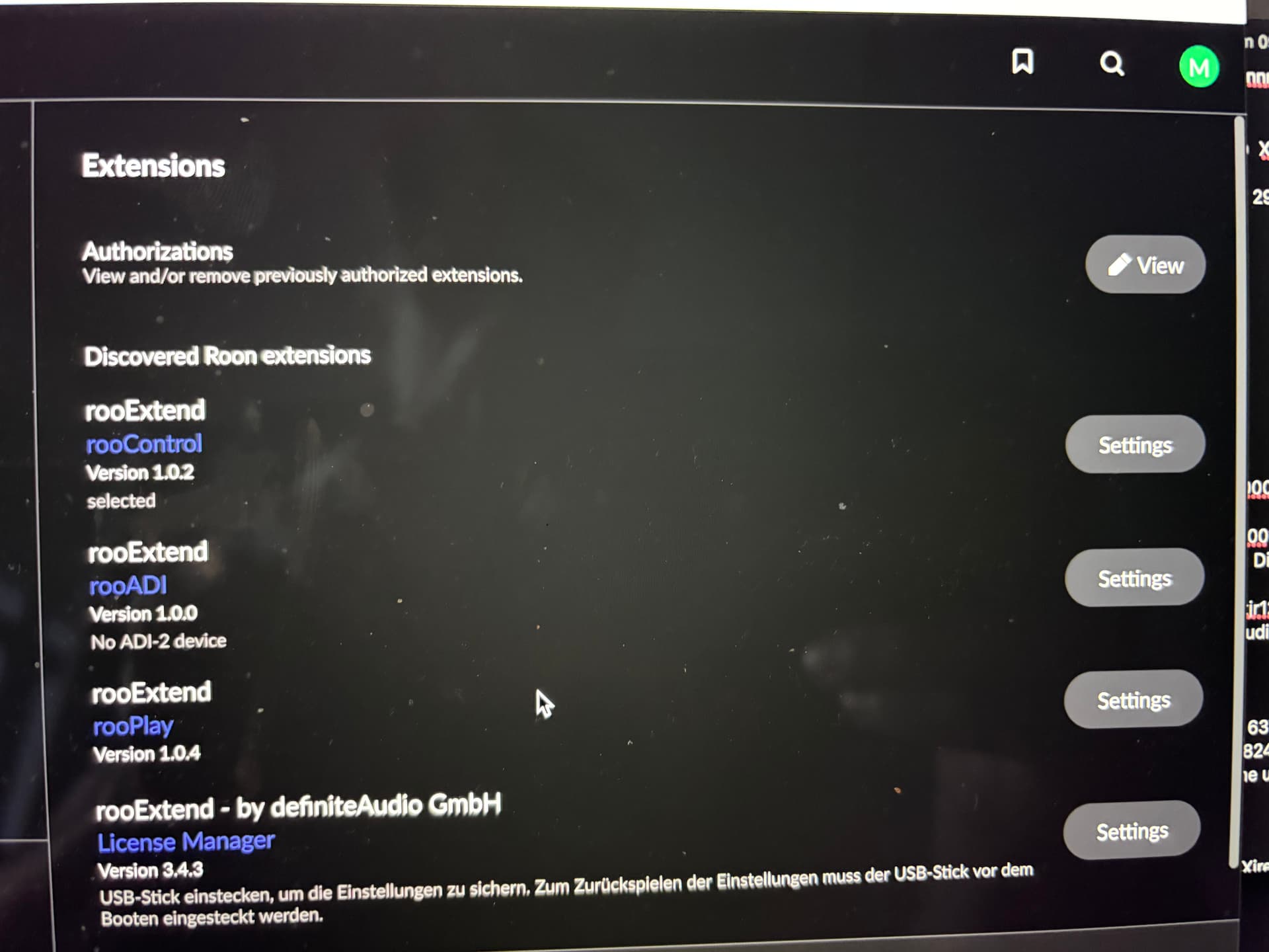

Hi DrCWO, after a reset of my my ADI-2 Pro FS my ADI-2 Pro is not found anymore in the extension manager under RooADi. I’ve checked the RME firmware - I am running the latest one.
Any ideas?
Add images
You probably forgot to re-enable MIDI support in the settings :wink:
ADI-2 Remote: (…) - no response [SOLVED] (Page 1) — ADI-2 & 2/4 Pro series, ADI-2 DAC series — RME User Forum
Best DrCWO
Absolutely. Didn’t know that was needed. Works fine again, thanks!
