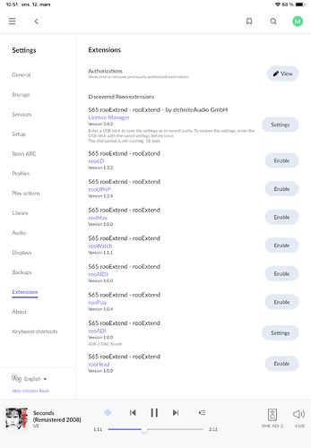

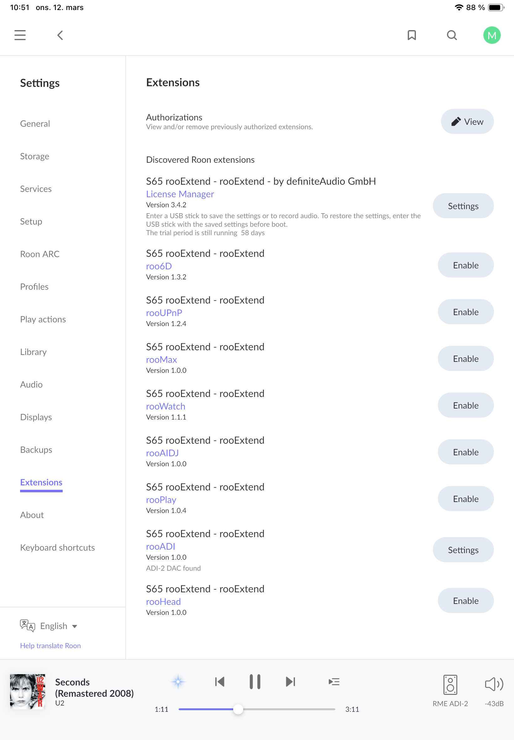

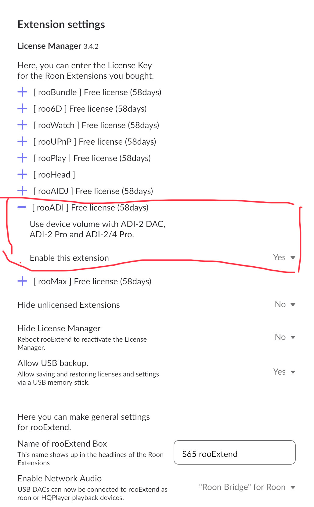

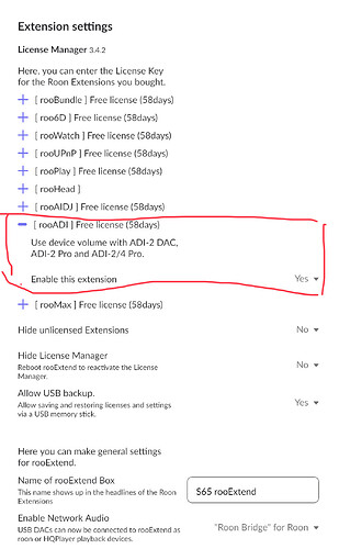

Hi @DrCWO , after purchasing the rooExtend-box I am now a happy user of rooADI to control volume of my RME ADI-2 DAC. I have also purchased a Surface Dial, but am waiting for a USB-extender from Amazon as the Extend also functions as a Roon bridge with USB into the RME. Hence, the USB-antenna is not attached to the box yet. My question is therefore, is this the reason why the rooDial-extension does not show up in the extension list within Roon? (please see below screenshot)
Additionally, I have purchased a lifetime license for rooADI, but there is no field to enter the license code. Is this because the trial license still is active? And will the license field then be available once the trial expires?
best regards
Magnus
Great, thanks’ for your order :grinning:
I’m an ADI 2/4 owner and like it very much as I use its four analog outputs to drive my 2x2 system. Two Woofers and two Horn. XO and DRC is realized within Roon by Acourate.
Exactly :+1: No antenna, no Bluetooth, no rooDial :wink:
After expiration of the trial you will see the field where you can enter the License Key.
Best DrCWO
