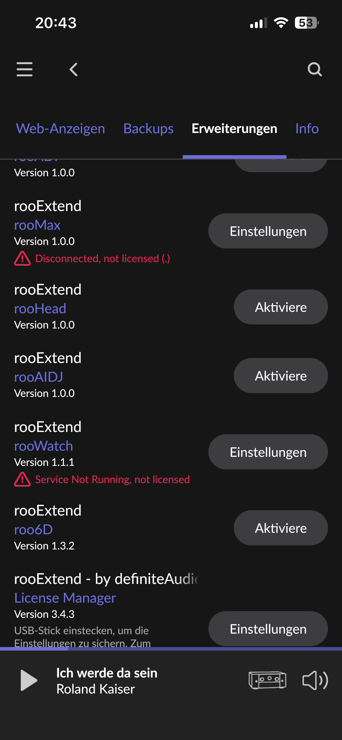

Hello Dr. CWO, I received the RPi4 yesterday, installed the corresponding image and hey presto: my suspicion was confirmed. Without knowing the exact technical cause, the Extension Manager is now visible in the Roon app and I can see and activate various extensions. I can also open the admin page via the browser. The only thing I have failed to do so far is set up rooWatch, even though I followed the instructions. But I suspect that it has something to do with the WiFi setting on my watch. I will continue testing and will get back to you if necessary. Best regards, Oliver
Good to hear :+1: But still a mystery to me …
Please enter the IP of your rooExtend (you find it in Roon Settings/Extensions of you open the settings of the rooExtend License manager at the end of the dialog) in the rooWatch app and retry.
Best DrCWO
I had done so, but it is not connecting.
I have mentioned, that there is an entry under the license item that sounds like „service is not running, missing license“
Is this normal for testing period?
Regards
Oliver
hello again, I have now tested again: rooextend is running and roowatch reports “service not running, not licensed” in the extension manager. My Apple Watch is on WLAN (private, static) and the fixed IP of the extend box is entered in the roowatch options. result: connecting and no zones… until the dismiss message comes… and then in the loop

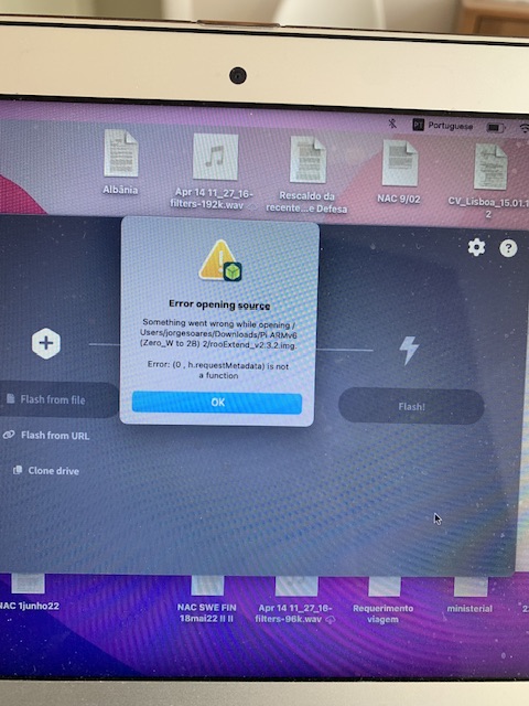

Hello, Using a Mac to flash the card. Unfortunately Ballena says ‘error opening source’. Please see photo.
I am selecting the img file.
Could you please help!
