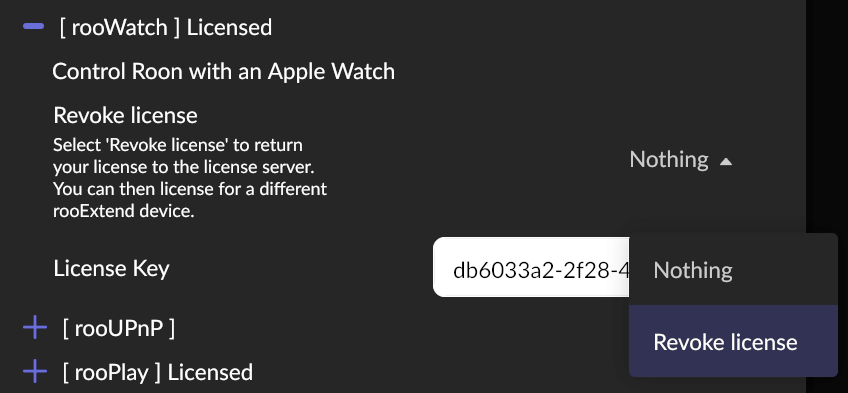

Hello
I had to replace my rooExtend Box and now have a Raspberry Pi running. The backup failed. Now I wanted to re-enter the license keys on the Raspberry Pi. However, I cannot save them. Do the license keys first have to be released from the old box? If so, how can I do that? I no longer have access to the old box.
Bruno
Yes, you have to revoke the old Licenses on the rooExtendBox before being able to use them on the Raspberry Pi.
For revoking open the Settings Dialog of the License Manager on the rooExtend-Box and select “Revoke license” for the Roon Extension you like to revoke.
After revocation you can use the revoked License Key with your Raspberry Pi.
Best DrCWO
Thanks a lot, but I no longer have access to the rooExtend Box because it won’t start up anymore. I’ve tried everything, but nothing helps.
Bruno
If you are able to flash a SD-Card with Balena Etcher I can provide a SD-Card image for the rooExtend-Box. You can try this as I never saw a rooExtend-Box dying until now. But SD-Cards sometimes die during power up.
Please let me know.
Best DrCWO
Please send me an SD card image. Do I need to boot the rooExtend Box with the new SD card using the USB stick backup?
Bruno
Just wanted to share my feedback to current users and prospective buyers of the rooExtend box. My SD card failed and DrCWO was very responsive in providing the software file to flash to a new card, guiding me through the process, and re-enabling my extension licenses.Thank you for your help.
