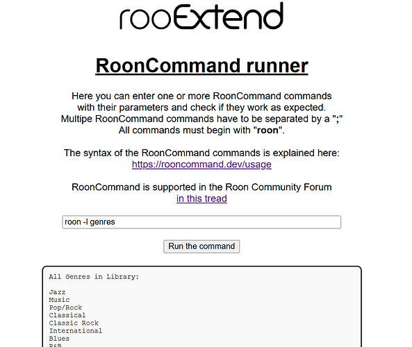

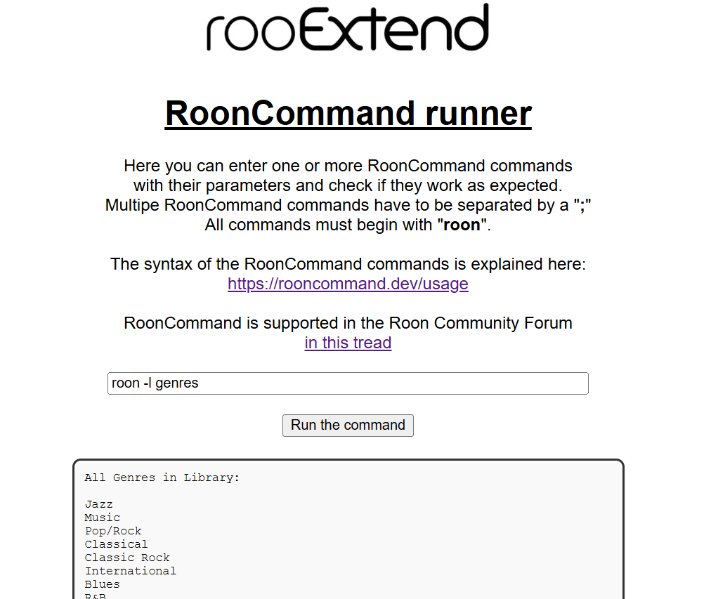

RoonCommandline

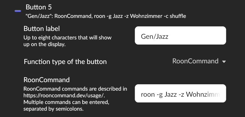

As one of the great improvements RoonCommand is now part of rooExtend. With RoonCommand, you can define various actions in Roon via a command line syntax and assign them to buttons in rooMax. Details regarding the RoonCommand syntax can be found here.
RoonCommand must first be enabled in the rooExtend License Manager. After having done that close the dialog of the License Manager and look for the RoonCommand Roon Extension coming up. Also the RoonCommand Roon Extension has to be enabled here. Now watch Roon/Settings/Extensions for a while. There will some quick changes you will see until after a minute the display stabilizes. Now RoonCommand is ready to be used.
Opening the rooExtend Service page you will find a section about RoonCommand and Links to the documentation and the RoonCommand runner. You can enter commands here to test if they work as expected.
If you got a command that woks just open the settings dialog of rooMax and assign it to a button.

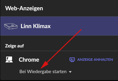

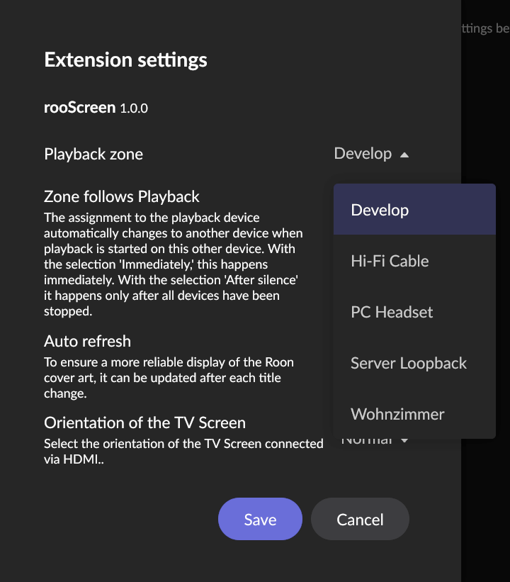

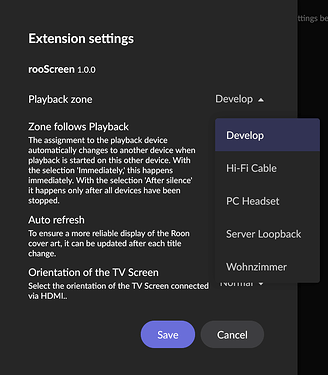

RooScreen is no longer working (for me). More precisely: since the software was updated to include RooScreen, no images are displayed. No matter what settings I adjust, I only see the software adaptation of the Qlocktwo (Biegert & Funk). The only thing that works is screen rotation. Otherwise, only the Qlocktwo screen is visible. Roon has no problem displaying the images, and the Russell V TV Remote works perfectly on Apple TV.
What do I need to do to get the images displayed again?

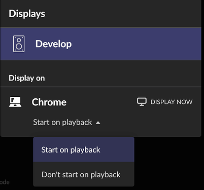

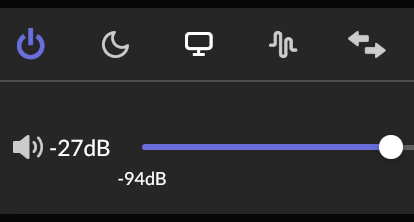

If the clock is displayed anything seems to work as it should. To bring up the Roon Art you have to do:
First select the zone to be followed in the settings of rooScreen.
After that playback something in this zone and the roon Logo will appear on the screen.
After that open the volume control in the Roon GUI and click the screen symbol.
In the upcoming dialog select “Start on playback”
and after that clock “Display now”
This will show the Roon Art. Stopping playback and/or clearing the queue will bring back the clock. Also of you turn off the DAC the clock will display again.
So if your rooExtend stays on all the time the Roon Art will be shown the next time you play something in this zone.
I re-tested right now and for me it works as it should :+1:
Best DrCWO
I was able to narrow down the behavior. The situation: Roon Rock was switched off overnight. The monitor was also off, of course. The Raspberry Pi with RooExtend is always on. I start the day, switch on Roon Rock and the sound system, and listen to music. A few hours later, I want to see the artist images. I switch the TV to the HDMI input of RooExtend. Since the TV and Roon Rock were switched off overnight, I only see the Roon logo. The screen icon in the bottom right corner is missing. Logically, since Roon Rock and the monitor were off. Using a shortcut on my iPhone, I “Restart Chromium.” Seconds later, I see “qlocktwo” on the screen, and the screen icon in the bottom right corner appears simultaneously. All settings are correct; nothing was changed. Only “Start on playback” needs to be reset. I activate playback, but nothing happens. No Roon logo, no images, but qlocktwo. If I play music continuously, nothing changes for the rest of the day. Except: I pause the music playback for about a minute. When I resume playback, the images appear automatically.
The “Automatic Update” setting in the rooScreen dialog doesn’t change this behavior. Except that I then have the fade-in and fade-out effect with every new track, which I find annoying.
Before rooScreen, I could simply restart Chromium at any time, click the screen icon, and it would work. Now I have to make sure no music is playing before clicking the icon after restarting Chromium. Then it works as described.

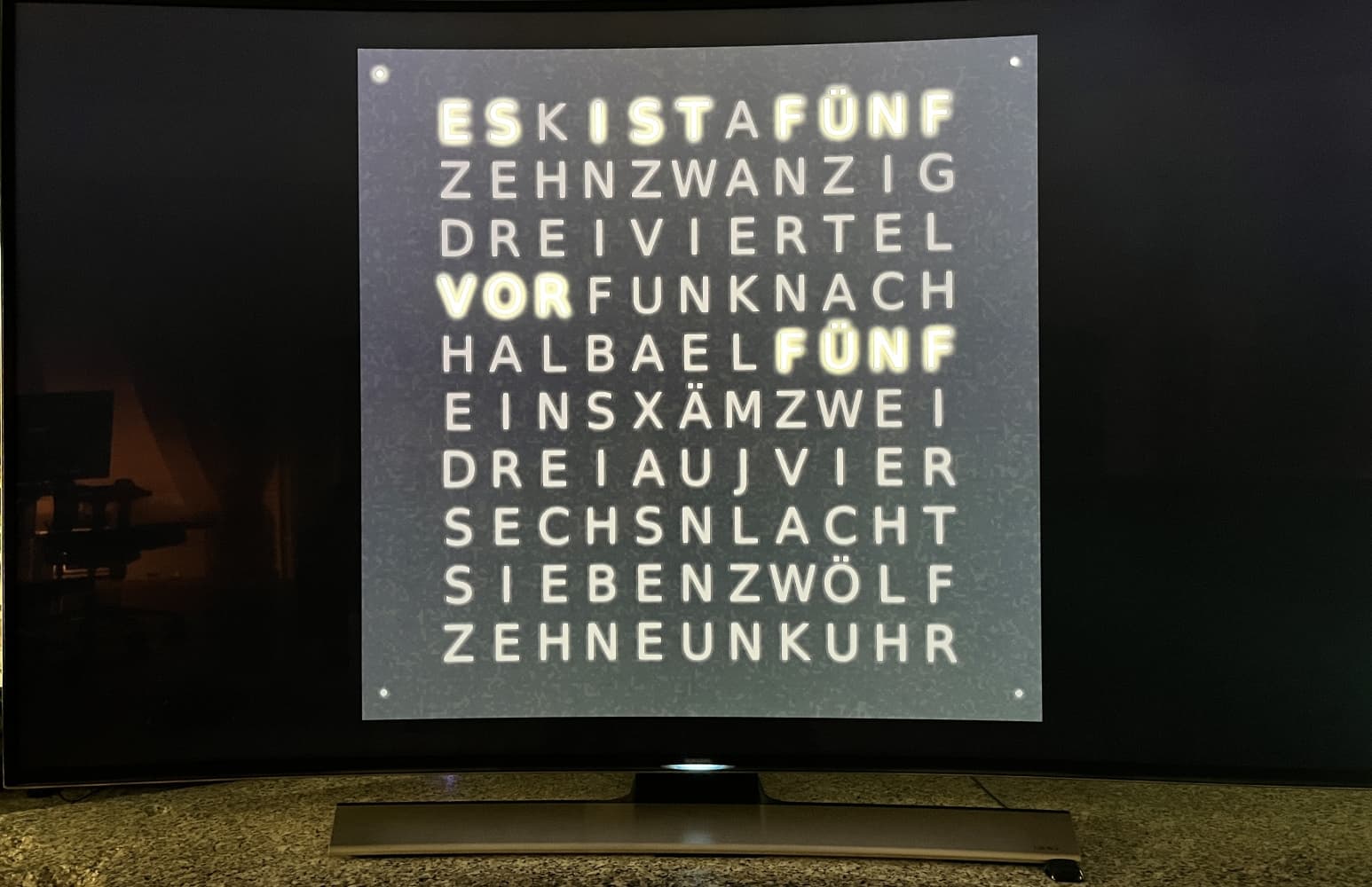

Note: qlocktwo is brilliant. If the (currently) gray background could be changed to be as black as the screen, it would be almost perfect. To make it absolutely perfect, the language could also be changed. A friend of mine has it set to Swiss German. More than “nice.” :grin:

I can implement a swich to tun the gray on and off :slight_smile:

I personally would prefer if “Start on playback” were the default setting. Is that possible?
Me too but restarting Roon this is always off and I can’t change this :sleepy_face:
