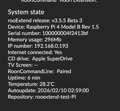

Hello Dr CWO! I am excited for rooScreen as it fits my needs perfectly. Thank you very much for providing this for free. I am having a problem though. I do not see the “Chrome” Display in roon settings. I followed your guides to apply the hotfix and rooExtend updated itself to 3.5.3. I followed the guide for rooScreen and could not get past the “Displays” settings. I’ve restarted the roon core, restarted rooExtend, restarted the display, but I see no Chrome Web Display in roon. The screen I have connected to the Raspberry Pi displays the default word-clock when idle and displays “roon” on the screen when roon is playing. Any tips to resolve this?
Also, the displayed clock is the incorrect time zone, how to set that?
I’m running roon Core v2.58 on a QNAP NAS.
rooExtend release: v3.5.3
Device: Raspberry Pi 4 Model B Rev 1.5
Memory usage: 427Mb
IP number: 172.31.255.207 (via WiFi)
Internet connected: Yes
CD drive: –
TV Screen: DZX-Z
RoonCommandLine: Unpaired
Uptime: 31 min
Temperature: 44.3’C
Autoupdate: 2026/02/09 03:52:00
Repository: rooextend-prod-PI

New to rooExtend, so might be missing something.
Having similar issue with rooScreen.
Yesterday i’ve setup rooExtend on Raspberry Pi 3B (tried older image on Raspberry Pi 2B v1.1 before, but for any reason it was booting up fine, however rooExtend service was not really starting, and it didn’t show up in Roon, and web interface was not working, refusing connection).
Added license to rooWatch and after that applied hotfix and updated it to 3.5.3.
After update rooScreen showed up, however it’s not working. When zone isn’t active, it just shows empty square where clock should be, clock as such never shows. Also rooScreen is not showing under Displays in Roon. When i start playback it just shows “Roon” and that it.
What is even more interesting, now i cannot access License Manager settigns screen. Whenever i click settings button, rooExtend service crashes and restarts.
This is what shows in the logs:
Feb 09 22:03:48 rooExtend rooExtend[2208]: ***** Error: rooCommandLine.js: cannot read in readSettings/usr/local/Roon/etc/roon_api.ini
    Feb 09 22:03:48 rooExtend rooExtend[2208]: Caught exception: TypeError: Cannot read properties of null (reading 'length')
    Feb 09 22:03:48 rooExtend rooExtend[2208]: Exception origin: uncaughtException
    Feb 09 22:03:48 rooExtend rooExtend[2208]: ===== Abort by uncaught exception =====
    Feb 09 22:03:48 rooExtend rooExtend[2486]: ----- stopping websocketserver...
    Feb 09 22:03:48 rooExtend rooExtend[2486]: ----- stopping websocketserver... done
    Feb 09 22:03:48 rooExtend rooExtend[2208]: ##### Terminated: rooControl with code: 3
    Feb 09 22:03:48 rooExtend rooExtend[2208]: ##### Terminated: rooWatch with code: 3
    Feb 09 22:03:48 rooExtend rooExtend[2208]: ##### Terminated: rooScreen with code: 3
    Feb 09 22:03:51 rooExtend rooExtend[2208]: Terminated successfull
    Feb 09 22:03:52 rooExtend systemd[1]: rooExtend.service: Succeeded.
    Feb 09 22:03:52 rooExtend systemd[1]: rooExtend.service: Consumed 34.363s CPU time.
    Feb 09 22:04:02 rooExtend systemd[1]: rooExtend.service: Scheduled restart job, restart counter is at 2.
    Feb 09 22:04:02 rooExtend systemd[1]: Stopped rooExtend service.
    Feb 09 22:04:02 rooExtend systemd[1]: rooExtend.service: Consumed 34.363s CPU time.
    Feb 09 22:04:02 rooExtend systemd[1]: Started rooExtend service.
I tried “Reinstall Roon Bridge” as well as “Reset to factory defaults” and remove all extensions from Roon, and re-add everything. Didn’t help, both issues still present. Was thinking about starting from scratch and burning new image once again, but i don’t know if my rooWatch license will work after that, and since i cannot access License Manager settings, i cannot even revoke the license.
You are the third with this issue. Did you run Roon ROCK? If not on what Hardware Platform your Roon Core ist installed?
There is something absolutely wrong with your installation.
  • Please restart the whole thing from scratch by copying the ARM V8 image to the SD-Card.
  • Next Apply this hotfix
  • After hat wait for two nights until the latest update got installed and retry.
The crash you encountered has to do something with RoonCommand. Did you enable it?
Best DrCWO
EDIT:
I checked the error message again and found that I already fixed some thing regarding this issue in my code. If the issue persists please let me know. I can get you a beta.
No, not ROCK. Running Roon on M4 Mac Mini.
Happy to do that, but need to know my rooWatch license will work after reinstall, as now i cannot revoke it :slight_smile:
Good question, can’t remember now…
As said, i can reinstall and let you know, but need to know about my rooWatch license. If it’s ok to reinstall without revoking it first, i will do it right away.
Isn’t forcing update using “Look for software updates” the same? This is what i did yesterday after hotfix, and immidiately got 3.5.3.
Get back to me if this will become an issue. Using the same Pi it should work.
You can also do this :slight_smile:
