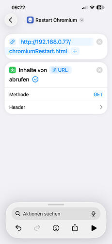

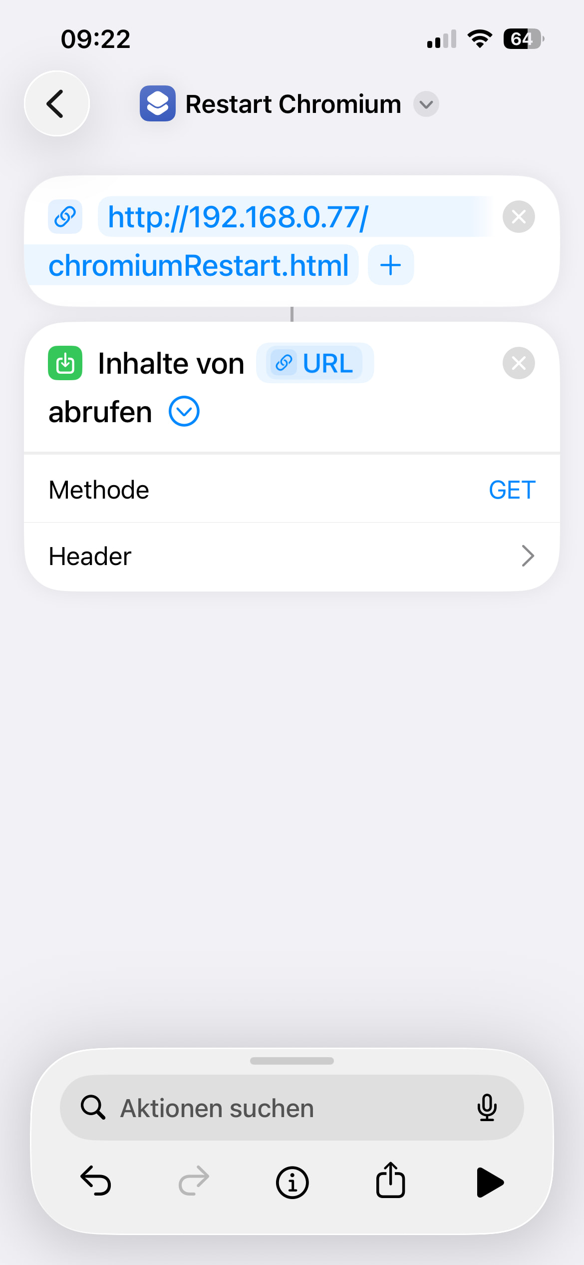

If you want to execute the command via the browser, use http://192.168.0.xx/chromiumRestart.html
If you want to use a Shortcut via iPhone use: Retrieve content from URL (in german it is “Inhalte von URL abrufen”). Replace the ip-adress with yours.
Thanks @StereJo , but I’m looking for the command to restart rooExtend itself, not the command to restart the Chromium browser used as a Roon Display on an HDMI connected monitor.
