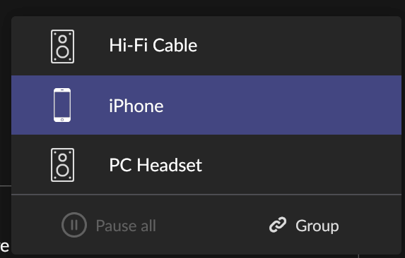

On your PC/MAC:
  • Open Roon
  • Click Settings (Wheel)
  • Click Audio. If Roon is active on the iPhone (and the iPhone is not sleeping) you see this on the PC/MAC screen:
  • Click the wheel and select “Device Setup” and you will get this:
  • Set the “Private Zone” switch to “No”
  • After that you are able to select the iPhone as a playback device using Roon on the PC/MAC
Best DrCWO
Thanks a lot!
It was the private zone!
Best regards!
Alex
