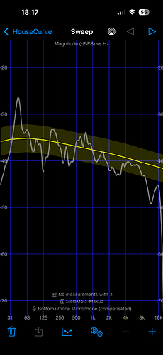

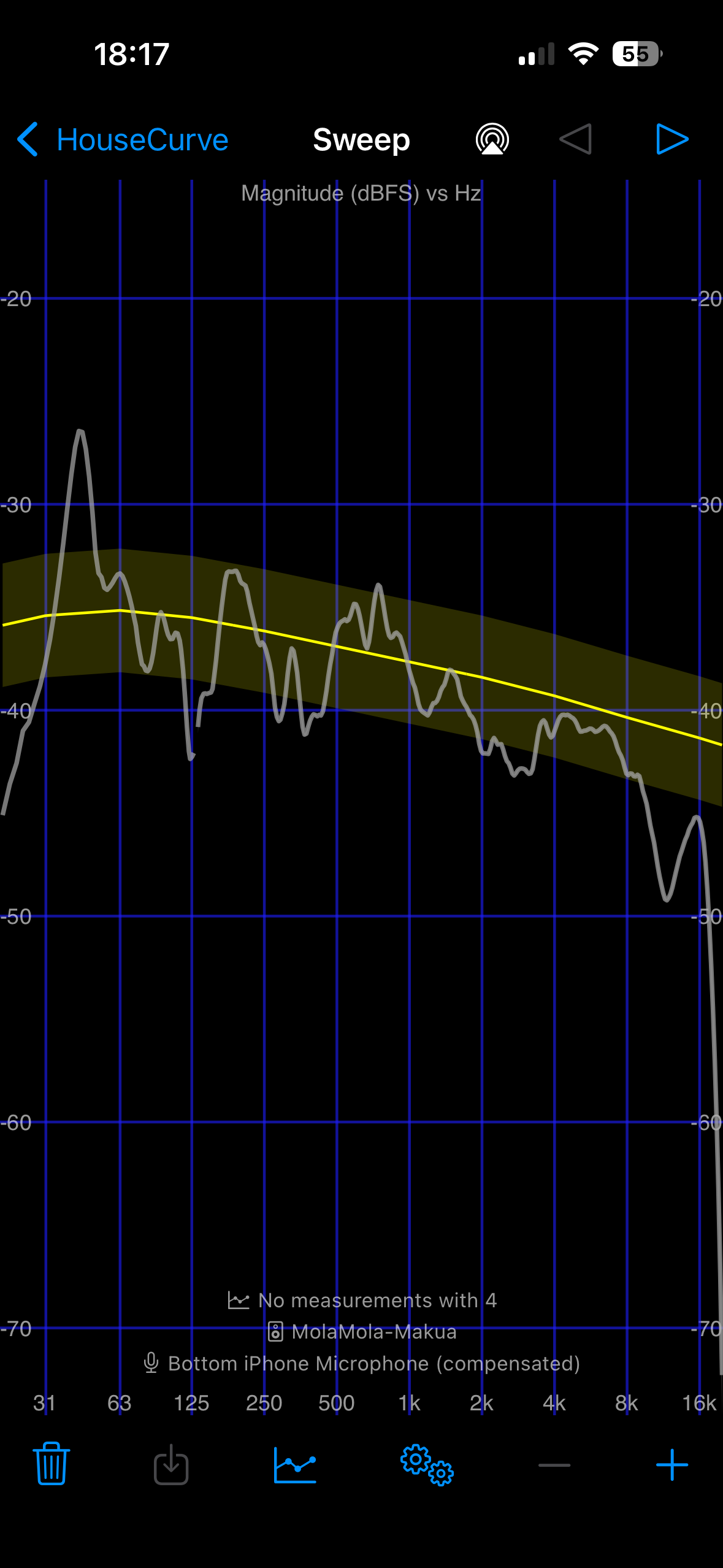

Lot of information here. Been looking at using housecurve and a plug in mic. Started with the demo version to work out what /if it’s needed.
If I am honest not 100% sure I know what I am looking at
Done a few sweeps and don’t even know if it’s worth buying the app to tune roon or not
Get curves that look like the below.
Will look at a usbc mic and a subscription/ purchase of the app
