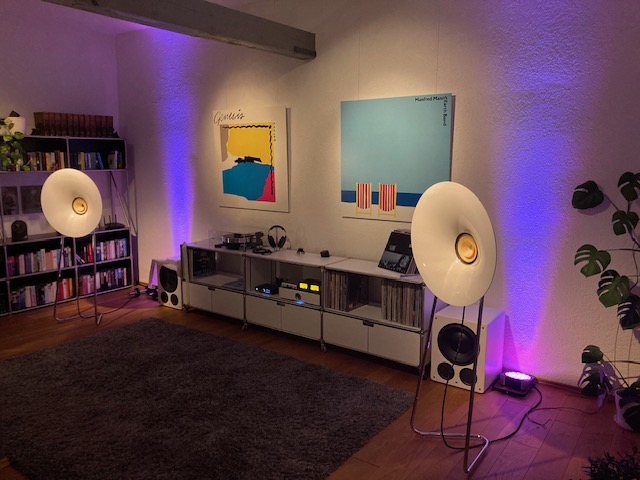

B.T.W.
I currently drive my 98dB sensitive full range horn speakers with the Topping A70 headphone amp :grinning:
This can be done as the impedance of the full range drivers is 15Ohms (rising a bit to higher frequencies) and the amp delivers 17W at 16Ohms without any noise and distortion. A killer combination :grinning:
IMG_0671
The foots is from my new listening room in Fürth which is finally ready for guests now :+1:
Best DCWO
Nice. But, what caught my eye was the large print of Chance by Mandred Mann’s Earth Band. Great album. Where did you find it?
Custom made by a Service Provider whom I sent a Foto from the Album cover (100Mpixel :+1: ). With $500 per large print (1m x 1m) you’re in :wink:
