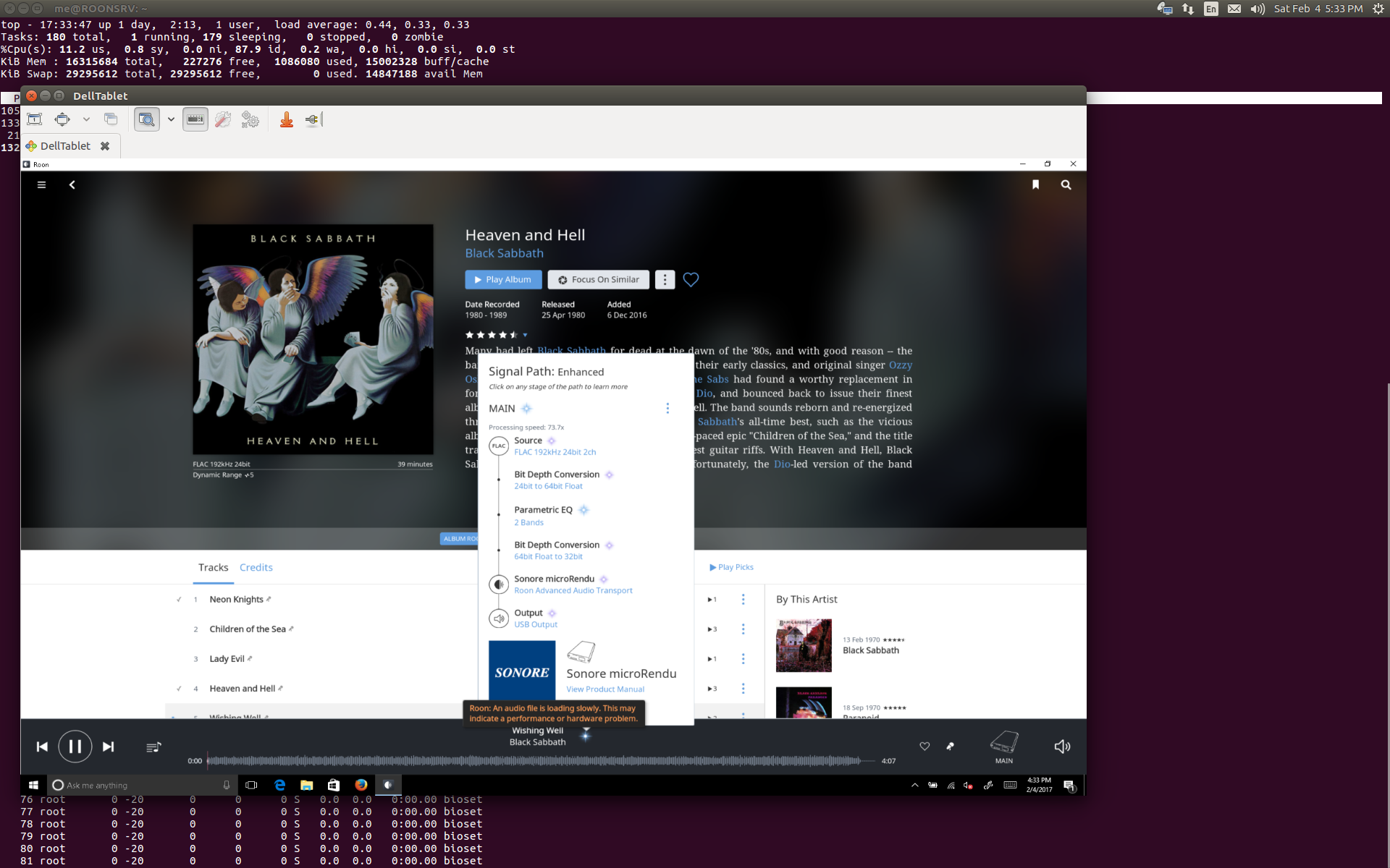

I’m toying around with the new Parametric EQ settings in Roon and have determined that there are two Freqs that require tweaking. This info was gathered by first taking measurements using my XTZ Analyzer setup.
Anyway, I have applied the changes and all appears to be working as expected.
My question though is two fold:
  1. What is considered a good “Processing Speed” when viewing the Signal Path Info during playback of audio? Mine appears to be running consistently in the 220x range as seen in the screenshot.
  2. As I view the various steps within the Signal Path window I see that the signal is first bumped up to a 64Bit Float, EQ is applied as expected but then its gets interesting. I see that the 64Bit value is then dropped back down to a 32Bit Float value…Hrrrmmm? I guess I was expecting to see it fall back down to the original 16Bit value.
Thoughts?
Thanks
As long as processing speed is over 1.x, you should be fine :wink:
FYI, my processing speed is never over about 2-3x with conversion to DSD128 - jealous of your 222x!!!
Re 2: all of Roon’s DSP is done on 64bit floating point numbers, so we always convert to 64bit as a first step. But, once we have 64bit data there’s no reason to reduce it any more than necessary, so we just convert down to the highest bit depth the downstream components can handle.

Now I have one more question on an issue that I just noticed. You can see in my first screenshot things appear to be working as expected and playback was all good. That was with a standard Redbook album (ie…16/44).
I just now attempted to play a 24/192 file using the same DSP PEQ settings and playback just puked :sob:
It doesn’t appear to be a Resource issue despite what the Error message seen in this new screenshot would suggest. You can see in the background I have a Ubunutu “Top” session running on the Roon Core server. CPU was not even blinking and RAM is still plentiful (16GB). The ROON DB itself is local to the Core Box and is located on a 256GB Samsung M.2 Pro PCIe SSD card (ie…as fast as you can get). Ethernet is 1GB and all components are running on the same switch with NO Hops involved.
The Processing Speed has fallen to a less impressive 73X this time though :slight_smile:
Thanks…Thoughts?
