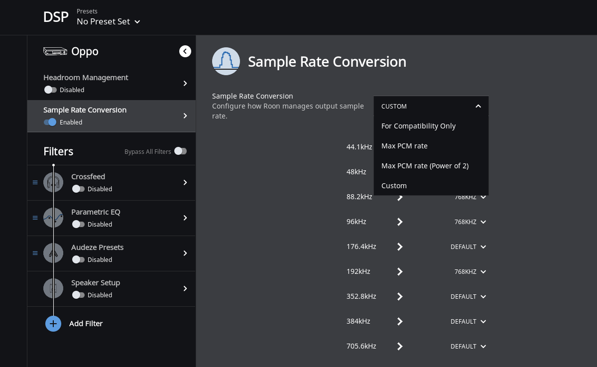

Is it me or did they remove the option to upsample to DSD in the new 1.6? I just have the option to upsample to go PCM 768 and I used to be able to pick true DSD512.

Yea that part is still there and looks fine. It’s when I go to the DSP settings and I used to be able to choose DSD and then the rate of DSD. I’m not seeing that…unless I’m blind or wrong…:grin:

Can you post the screen I have?
On the Sample Rate Conversion drop down list I used to have a DSD option and was able to choose which rate. That is GONE! However I do use HQplayer as well but I still like testing and comparing with the DSD settings in Roon.

Did we loose the ability to upsample to DSD in the DSP section?
Edit: changed the graphic to be more illustrative.
That’s up-sampling to PCM. I was able to upsample to true DSD and pick a rate such as 512.

Didn’t do a good job with the first screen grab. The new one should be more instructive.

Ok yea, I lost the DSD option in the drop down. I had it before the 1.6 update.
