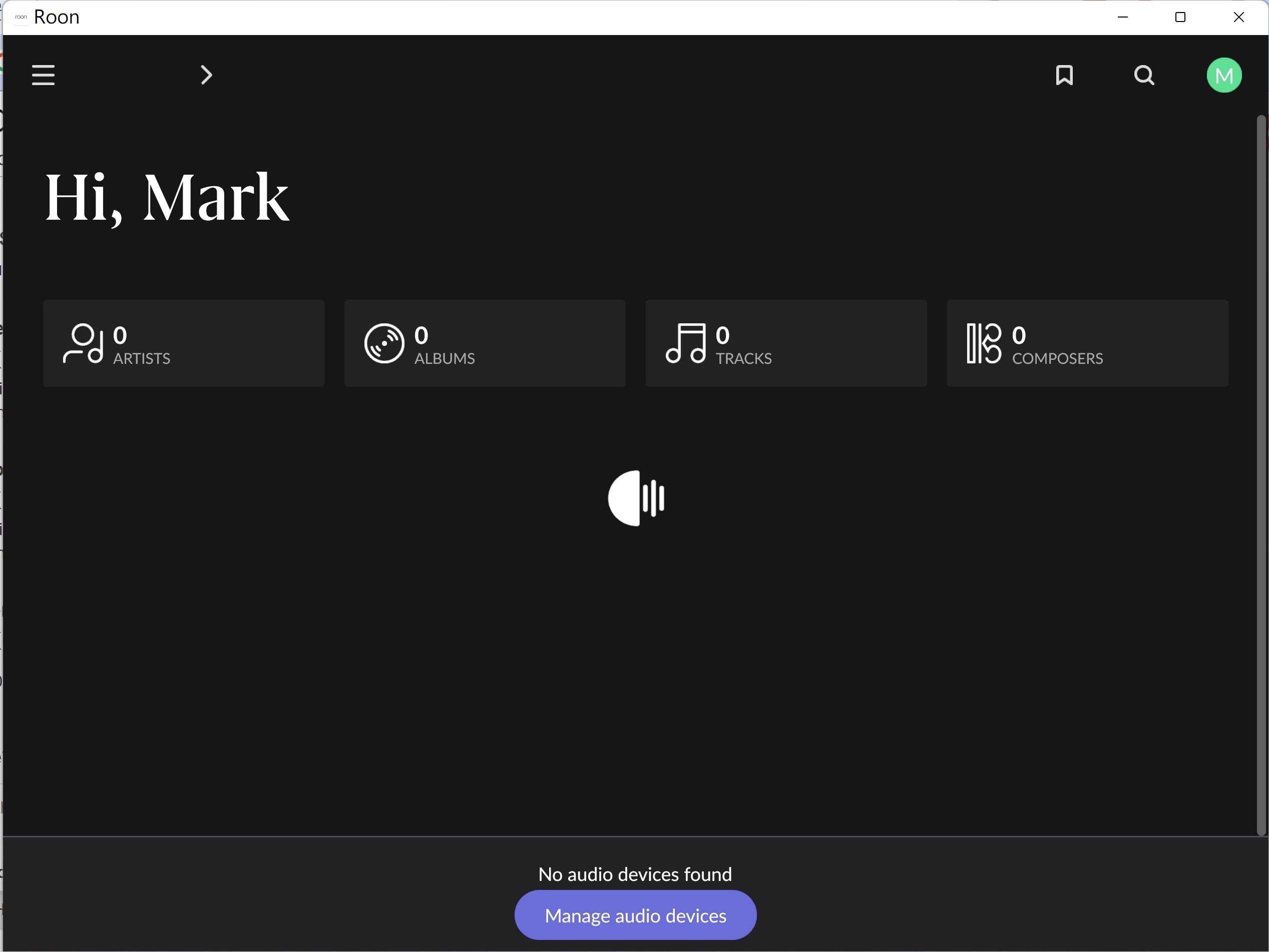

After updating the new(Build 1105) software, I can’t access all music files in my Nucleus Internal Storage. And Roon APP is always reading but can’t show any music. Can I have the previous version file to install in my PC and Nucleus? Thanks

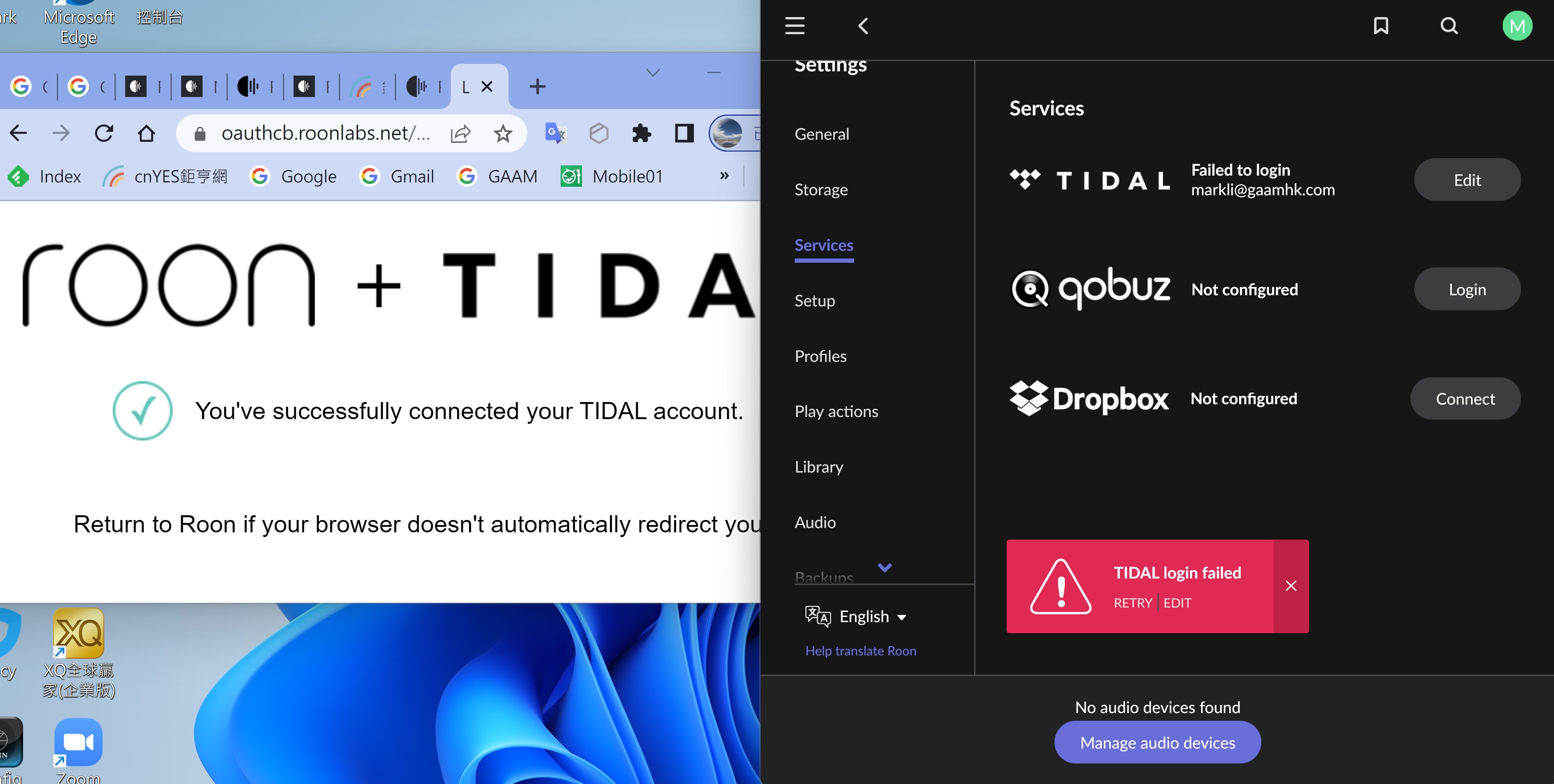

Now I still can’t access my music and find any audio devices in Roon. And it shows TIDAL login failed after I input correct ID and password.

Did you also try rebooting your router and any other network equipment?
If not try then it’s worth a go as typically this Tidal error is related to network connectivity.
Also worth trying:
  • Remove the Tidal account from Roon
  • Reboot the Nucleus
  • Create the Tidal account in Roon again

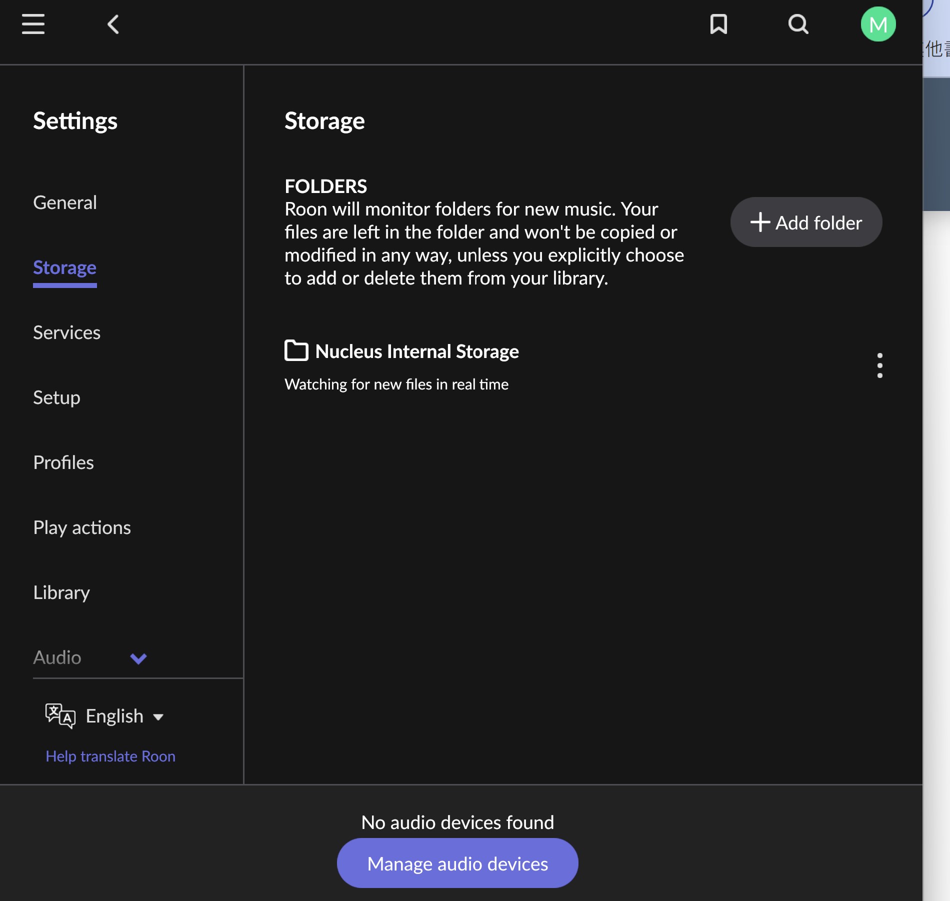

For the music files on the internal SSD, I’m assuming your Nucleus was fitted with a second SSD.
Let’s check if Roon is pointing to it, if you go to Settings → Storage it should be listed a a watch folder.
Can you post a screenshot of this page, a that will also help Roon’s support team.

Thanks for your reply. I tried all procedures you mentioned but still can’t solve my problem. The TIDAL original app runs well on my windows.
I did use a second SSD in my Nucleus. The screenshot is attached. Is there any procedure I can go back to Roon 1.8 (Build 1021) which works good?

Thanks for that, it looks ok to me. I’m sure you have done this already, but as a test are you able to see your music files on that internal SSD via the network share? Just wondering if the disk and it’s content are ok.

Unfortunately, I don’t have a DB backup. I started using Nucleus a week ago. I think the problem may not only on DB. I can’t access my music folder on my PC in Roon app and can’t use any speaker of my PC. Hope @benjamin can help on this asap. Thanks!
What is curious about your Settings > Storage screenshot is that there is only the message “Watching for new files in real time”. There should be a count of the total number of files that the Core has imported as well.
Can you click on the “3 dots” menu and force a rescan? Any difference?
I did rescan it earlier but the situation is still the same.
