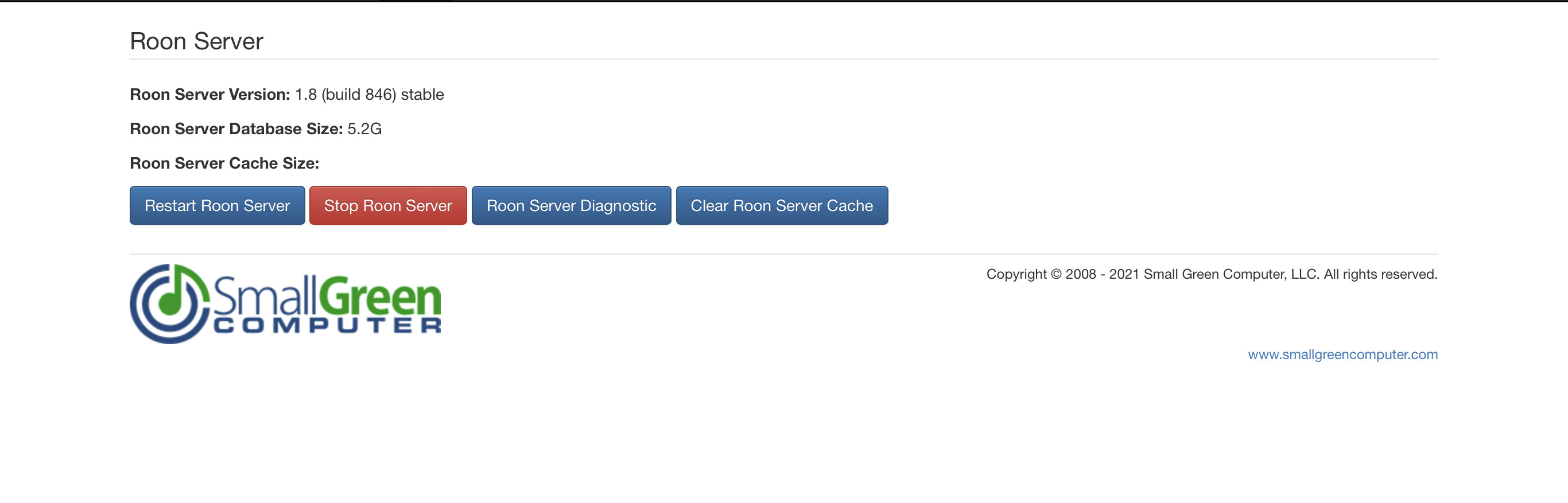

Same issue for me. Solution doesn’t work though. I’m on 2.8 for sonicorbiter and “Version 1.8 (build 846) stable” for Roon server on the i9.
Any thoughts @support ?
You need to upgrade it manually even you are already version 2.8. Please try.
Ah ok yep so keep clicking though on the Roon icon in the software updater area.
And then force the install.

Thanks for the reports here and for the clear update steps with screenshots! Thanks for bringing this to our attention, it will surely be helpful to any other users facing similar behavior!
You don’t need to reinstall Roon. All you need to do is press the update button
sonicorbiter.com → manage → apps → software manager → update
