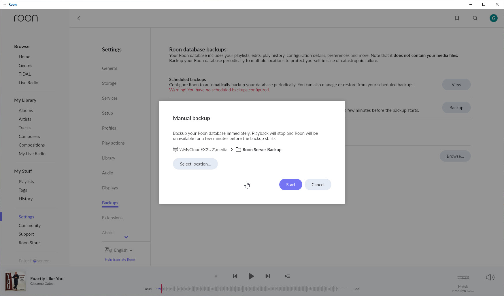

I’m not sure what all exactly happened with recent Roon updates but my stable backup has now turned into, unable to backup at all.
Below are screenshots of the problem:
I’ve “never” had this problem (until now) where snapshotting fails,
Select the same Roon Core, and that seem to cause snapshotting to continue, only to fail again,
And after few minutes, Roon UI shows up again,

Tried again, and this time backup has started, at least it has moved to the Preparing,
Yep the Core doe all the work , the Remote simply triggers it . Your screenshots look like at some time during the backup the Remote lost contact with the Core hence the “select your core” screen. Hence the network blip guess …
Once triggered the backup requires no input from you or the Remote so it ill almost certainly have completed perfectly.

Yep, looks like the Core did get the backups done that were initiated manually from Remote.
The individual backups seem to be all there.
I’ll need to monitor this particular Remote with the Core.
