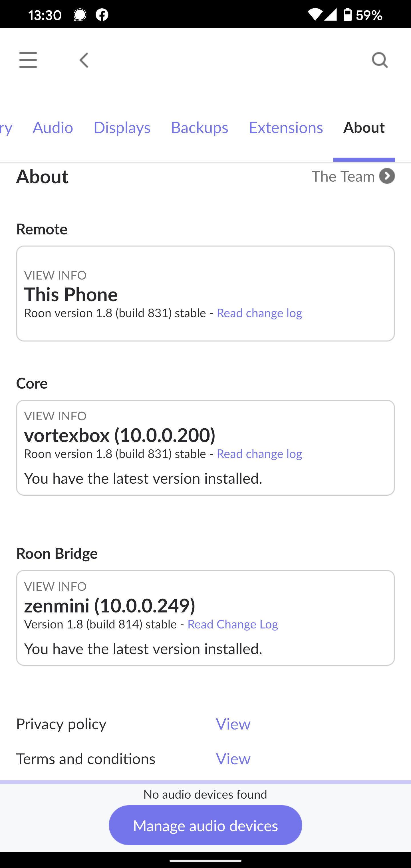

The Evo is seen on Roon as a squeezebox device. As the screenshot earlier shows, it cannot see it but is at the same time sees it as a core. The Evo is running USB to an aqua dac and that is not being found either. Neither is my Zen mini that is located downstairs even though it shows up in my about section of the Roon app. (screenshot added here)
