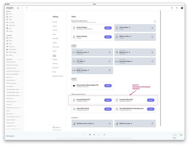

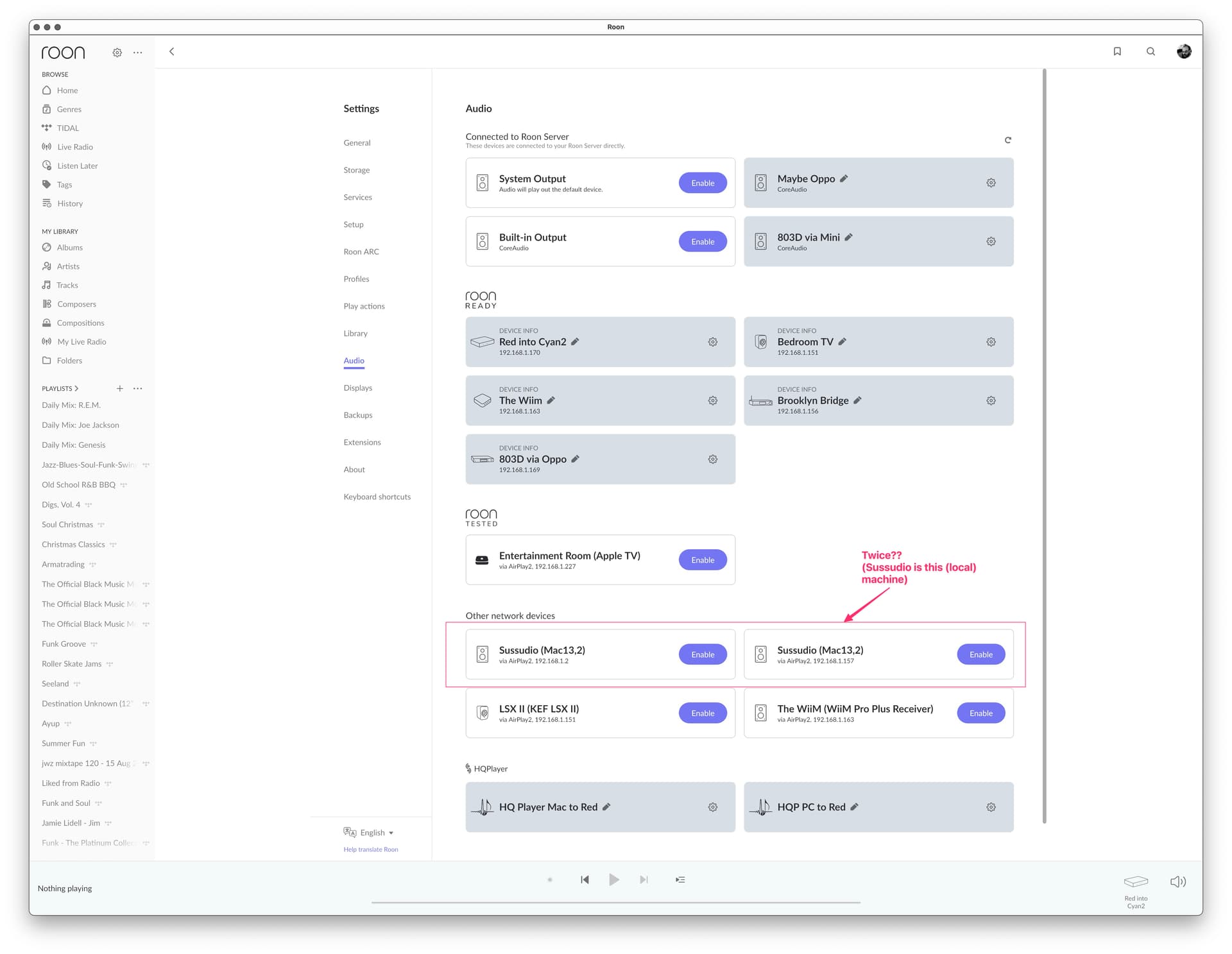

Ok, so I renamed my entire Roon folder (in ~/Library), and the existing compy of Roon in my /Applications folder, and downloaded it ‘fresh’. Unfortunately, the issue of the app not seeing my local audio options remains. I can still see the Connected to Roon Server, Roon Ready, Roon Tested, and HQ player sections in the Audio settings, but the section for local audio devices isn’t there. Interestingly, it can see my machine as an AirPlay 2 capable network device, twice. (see attached screenshot)

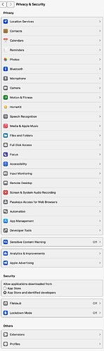

Got it, thank you! For your missing audio devices - can you please navigate to macOS System Settings > Privacy & Security > Local Network, and make sure Roon and Roon Server are allowed.
If it is already enabled, toggle it off and on again. Then reboot your Mac, and see if the same issue persists.
Thank you! :folded_hands:
So… I don’t seem to have an entry for “Local Network” in Settings/Privacy & Security for the OS… (macOS 14.7.7)
I also made sure Roon had “Full Disk Access” enabled (which it did).
Normal because you have macOS 14 and this additional lockdown feature was added in 15 (Sequoia) and can’t affect you.

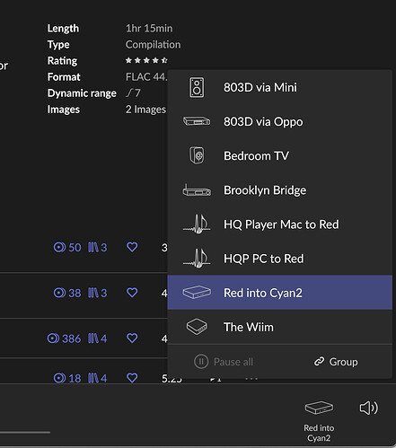

Update: I can reliably get them to disappear if I simply quit the app. It is currently unclear if quitting the app with a local zone selected will trigger the disappearance, or if I need to be currently controlling a remote zone when I quit the app:
Setup: App is open, set to a local zone (my desktop MM1s)
  1. Change zone to something remote. In this case Red to Cyan2. (note, playing anything isn’t necessary)
  2. Quit the app.
  3. Reopen the app, click on the zone list, and note that the local zones have disappeared (again).
Note, I haven’t figured out how to make them reappear.

What device are you using in the screenshot you just shared showing the list of Zones? Is this your RoonServer machine, or another Mac?
