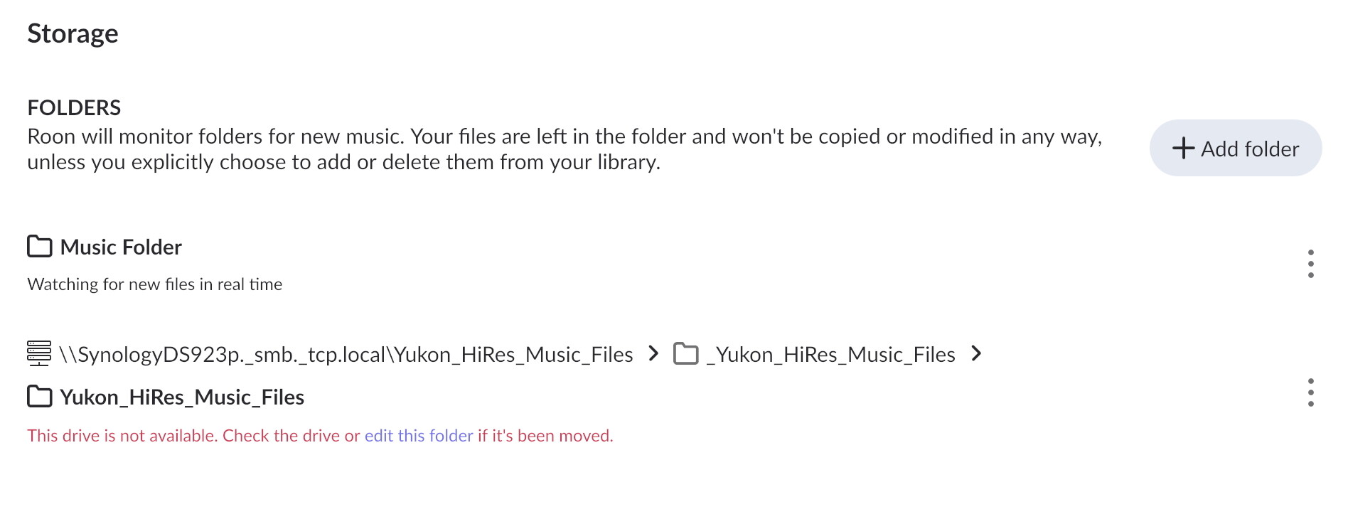

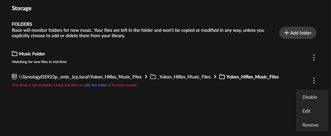

· I install updates as available. Updated to 2.66 (1658) yesterday and Roon will no longer connect to my SynologyNAS where my music files are stored. No other changes, just the update. Message: "This drive is not available. Check the drive or edit this folder if it's been moved." It is available and not moved. Tried to make a new connection and it won't see the server files at all now. Roon core is running on a Mac Mini 2024 M4 16GB running Sequoia 15.5 hard wired ethernet. Toggled the settings to allow Roon to find and communicate devices on the network and rebooted the Mac and no change. Thank you in advance for your help.

Just to clarify, can you access this network share location via SMB in Finder outside of Roon on the same Mac?
What do you see if you click the three dots to edit the watched folder? Please share a screenshot here.
Thank you and we’ll watch for your reply.
Yes, I have two shares on my Synology server dedicated to Roon. One is for daily Roon back-up, which is still doing its daily thing. Second is the share for my music storage. Both are fully accessible and mounted on my desktop via SMB. Here is the screen shot requested.

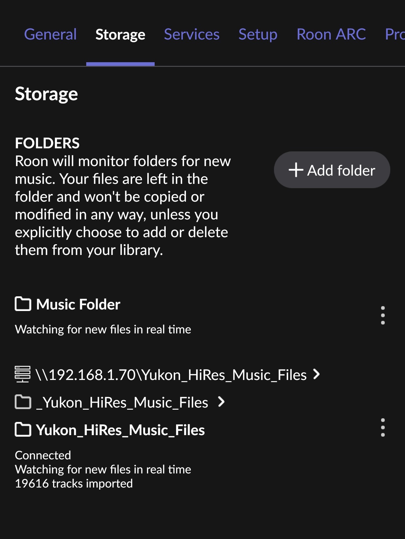

Thanks for the screenshots. Could you please try manually specifying the Synology IP address instead of using a .local address? Once that is working, we would also suggest setting an address reservation in the router so the IP does not change in the future. Let us know if this helps.

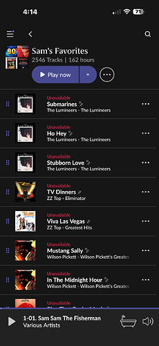

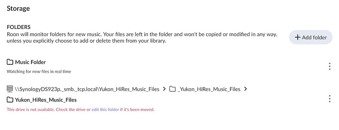

I specified the share address by the IP as instructed for the music files - screenshot attached. Roon scanned and completely brought in everything “fresh”. The problem I have now is my Playlists are still there, but all tracks are showing "unavailable” - screenshot attached. How do I fix this? Thank you

I see exactly what happened here. When you added the network share using the IP address, it looks like it was added as a completely new watched folder rather than editing the existing one. Because of this, Roon imported all the files as “new” music. Your playlists are still looking for the old file paths tied to the .local address, which is why the tracks are showing up as unavailable.

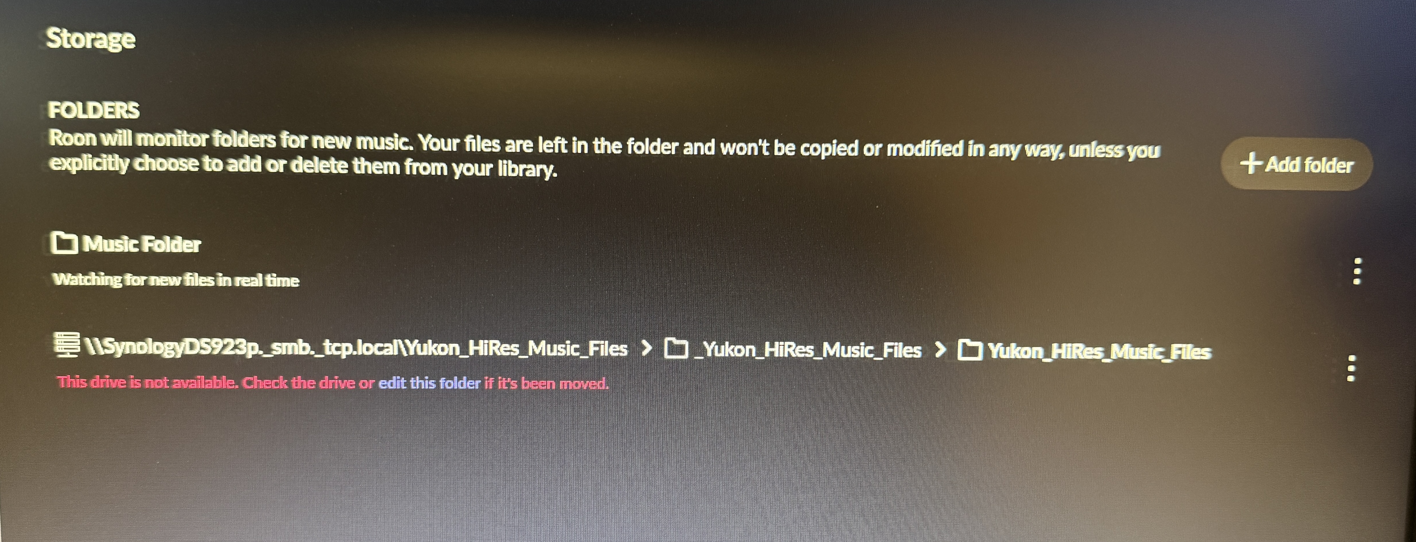

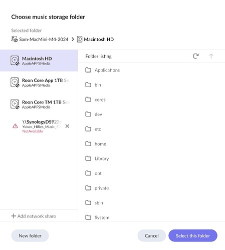

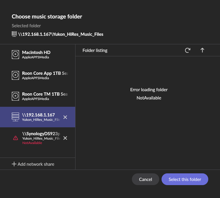

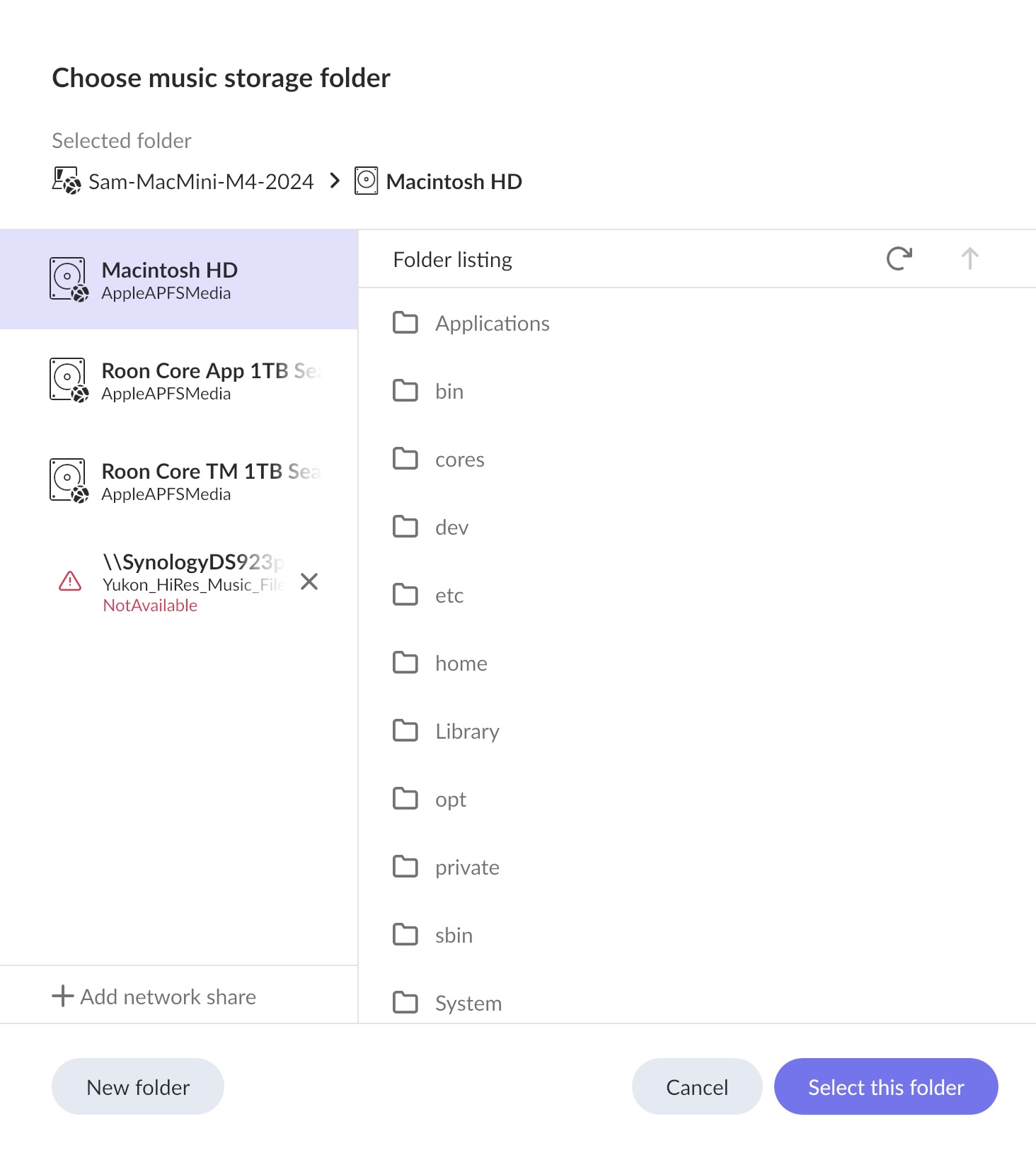

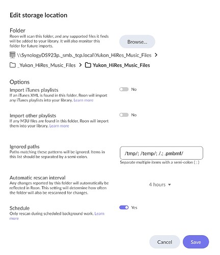

First, I was wrong that Roon was still backing up to the Synology NAS, but it is backing still backing up to my Apple mini, and an attached USB drive. I went with your option 2, rolled back/restored to May 1 (screen shot attached). Your step 4 is where I am hung up. “Settings > Storage > Click the three dots () next to the original .local folder, select Edit, and change the .local address to the IP address as described above” When I click the edit, it brings me to the “edit storage screen” (attached), and I see the address, but no way to edit it (?). When I hit browse, it takes me back to the “choose music storage folder” (attached) and no way to edit it there either. Help please!!!

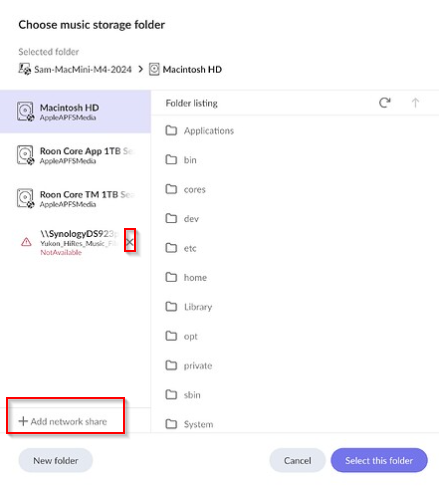

When you get to this step (after clicking the Edit button), you can clear out the old location using the X and specify the share via Add Network Share:
Please do not use “Add Folder” next to Folders:
The reason I believed this didn’t work last time is that it’s possible that Roon saw two copies of the music files at the same time, causing it to treat the duplicate files as “new”. Roon matches up existing database files by analyzing their music fingerprint (file hash), so it is important that files are only seen exactly once to preserve previous metadata.
If you have already had two copies of the music files at the same time visible to Roon, please restore a database backup and try the procedure to respecify the files location.
Please let us know if this helps.
Thank you, it’s all working again, and my playlists are all OK!
