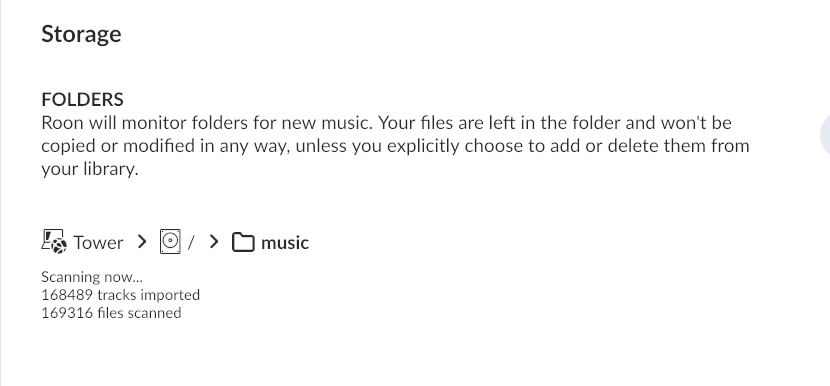

Storage shows “Scanning now...” stuck at 169316 files scanned / 168489 tracks imported.
Server logs show library finished, 0 tracks to reload, 0 changed objects.
No meaningful disk I/O from RoonAppliance.
Tidal scan finishes normally.

The network is stable. Music playback, browsing, search, and TIDAL all work normally. The only issue is that the Storage page permanently shows **"Scanning now..."** even though the library appears to be fully imported.

Storage shows “Scanning now…” permanently (72 hours by now, including restarts).
  1. Library reports 168,489 tracks imported and 169,316 files scanned.
  2. RoonServer log repeatedly reports:
    • library finished
    • 0 tracks to reload
    • 0 changed objects
    • music/librarymaintenance done
  3. iotop and iostat show essentially no ongoing disk activity from Roon.
  4. lsof shows Roon is accessing its database, not scanning files under /music.
  5. TIDAL scans complete successfully.
  6. The issue persists after server and client restarts.

Solved.
(Feeling not so smart here now.)
Had “non-music” files in the database. Have had for years. Have been meaning to do something about it, but ir was not a priority as long as everything seemed to be working.
So..
Switched to Unraid. Moved the database around a bit… and suddenly, this.
So i deleted ALL files that was not music files. And I fixed filenames where they were not up to my standard.
And suddenly everything seems ok. Scanned everything. Analysing now.
