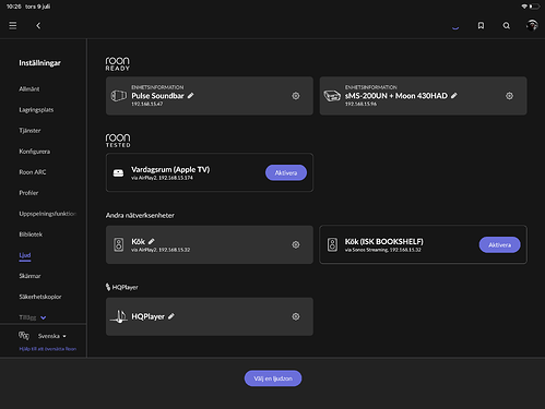

Before the update i had my kitchen speaker (Sonos) as well as my AppleTV visible.

Thank you! But i am way ahead of you! :grin:
Still no luck unfortunately, even though:
A complete network reboot has been done, everything from incoming FMC through router (Asus RT-AX82) and switches involved.
Roon Server (Win 11 IoT Edt LTSC, headless, fanless) rebooted, firewall checked for notifications - no change…
Everything else works, all RAAT endpoints, and of course Airplay though my iPad to the AppleTV, as well as the native Sonos app for the kitchen speaker. Both missing devices are on wifi.

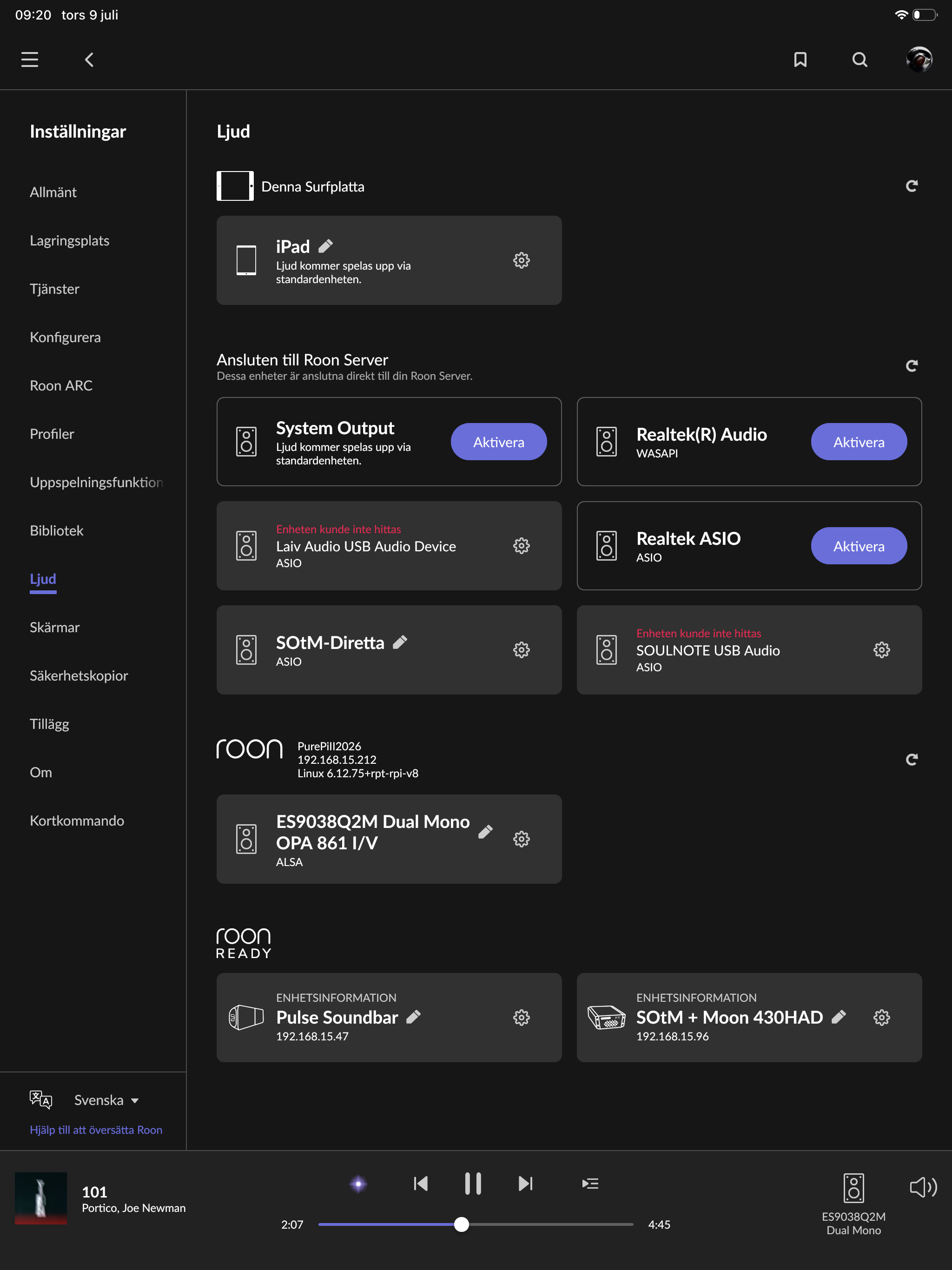

Started my alternate Roon Server, and switched to that one, running Roon 2.66 (also on Windows, though not fanless)
This core is configured in a similar manner to main primary Roon Server, and it’s wired to the same switch.
And the Roon Server “FractalCore I7” was updated to Roon 2.70, and the Roon Tested endpoints are still available on that one?

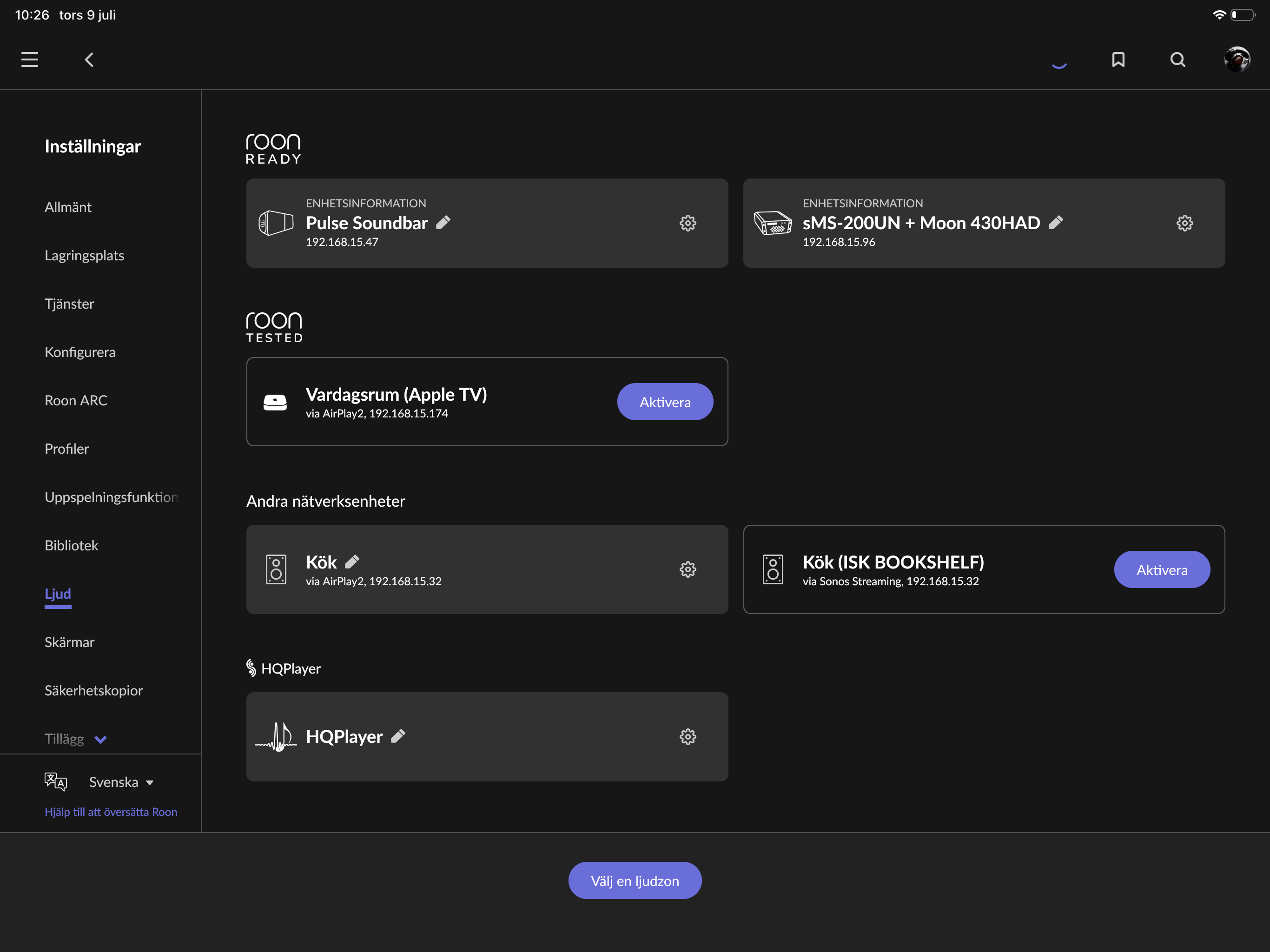

I had a feeling this might be down to an issue we looked at earlier this year. Or to be more specific, Roons startup and config is disturbed by my configuration:
I have two network interfaces on this machine, one for remote control, internet and Qobuz duties as well as Roon controlling. This is configured to DHCP with a reserved lease and not fettled with.
The other interface is the one causing this confusion, a dedicated interface for Diretta communication only which has only one protocol bound to it, IPv6.
So, rather than the command line you provided, i simply activated IPv4 (static) on the Diretta link, which then fixes the 10043 err. A reboot later and i’m up running again.
So, thank you again Ben, this was very helpful and clear! I know how to adress this, and hopefully the Roon startup procedure can be tweaked to not drop airplay/sonos if an interface with no IPv4 is detected.
