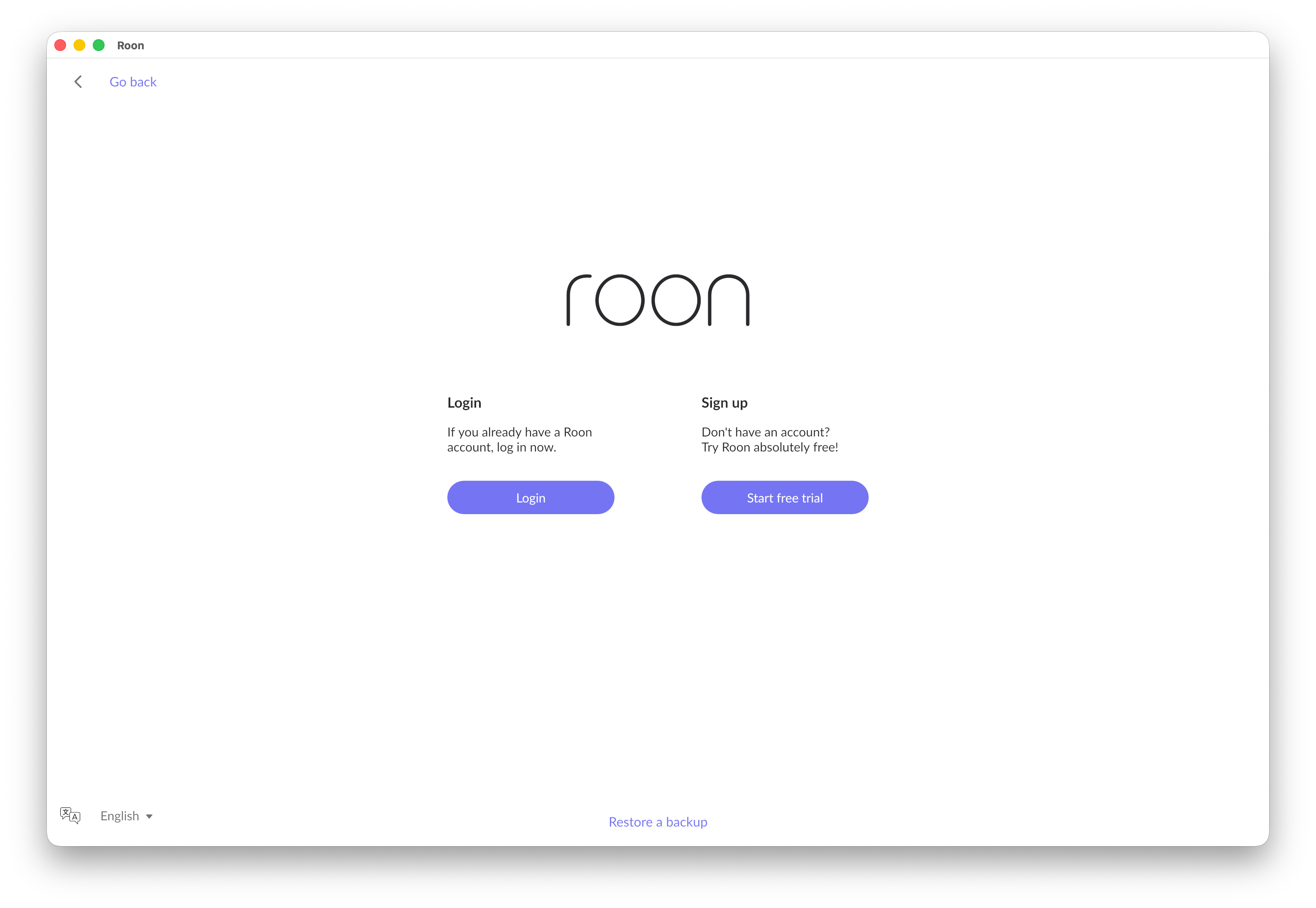

Roon 2.71 build 1683 login loop on macOS 26.5.2
I am installing Roon on an M1 Mac mini and configuring the same Mac as Roon Server.
Browser authentication succeeds and returns an authorisation code to the Roon application through roon://login?code=....
Roon Server then fails when exchanging that code for an account token:
GET https://go.roonlabs.com/Roon/account-token?...
The server log reports:
The SSL connection could not be established
followed by:
[accounts - LoginSSOConfirm] failed to login
The same SSL failure occurs for multiple Roon services, including updates.roonlabs.com, devicedb.roonlabs.net, device-map.roonlabs.net, push-manager.roonlabs.net and roonmobile.roonlabs.net.
Troubleshooting completed:
confirmed credentials work through the Roon account website;
tested Safari and Firefox;
deleted and recreated ~/Library/Roon and ~/Library/RoonServer;
tested home broadband and an iPhone hotspot;
confirmed correct date and time;
confirmed macOS curl successfully negotiates TLS 1.3 and validates certificates for the same Roon endpoints;
confirmed /Applications/Roon.app is correctly signed by Roon Labs LLC and accepted by Gatekeeper as a Notarized Developer ID application.
macOS: 26.5.2 public release
Hardware: M1 Mac mini
Roon: 2.71 build 1683 production
Logs attached.
Wessex Internet FTTP, Nokia Beacon 6 Router with Ethernet connection to Mac Mini
