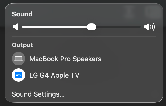

Can you please try to experiment with other thing.
Do you mind setting the Speaker of your MacOS as AirPort Express like on the screenshot below and then in Roon set the audio output as “System output”.
Will it still have a clicking ?

What? How?
Only happens with Roon to Airplay. I tried all combos of settings and you name it and have.

Hi @Quartet !
What I’m asking you to check will make your mac to AirPlay the content and not Roon. And the result will help us to understand whether it is only Roon’s Airport delivery causing problems or Mac’s Airplay too.
This helps to narrow down the scope of the issue and help us to investigate the problem.
Looking forward to your reply.
Regards.
